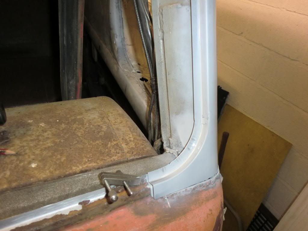

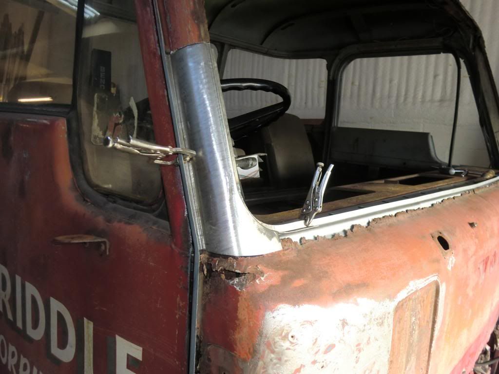

Evening all I’ve been doing a bit more to the cab,I removed the panel under the cab floor and step as the panel had some holes in it.
Also the the lower door hinge has had to be remade. I have then refitted the door to see if it fits before I make the new door skin.
I hope to get some shot blasting done (if it ever stops bloody raining) to the inside of the cab and the inner front panel.
So here are some more photos Phil

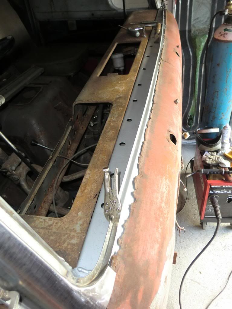

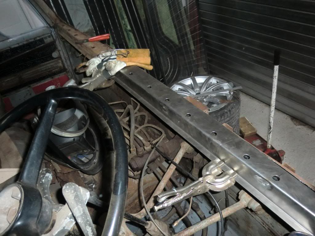

Wow! Proper restoration work. How many of the polished tarts in the shows will need doing again in five years? Not this one. Superb sheetmetalwork, if I may say so.
Did you use a folder or a pressbrake for the folds?
Were the flanges on the curved edges hammered over a wooden former, or some other method?
Are those resistance spotwelds or TIG “melts”? If they are MIG blobs, they are damned neat.

Thanks for the comments, I just do abit at a time, when I have a hour or so free I have a tig set, mig and also hand held spot welder plus foot spot welder so whatever does the best job on each part. The panels are made in a small brake press and
1m boxpan folder, I also have a shrinker and stretcher for forming curved panels,
The cab was very rotten in places but most panels had some part of the edge left so you could see where the bits should be
I am working on the windscreen area at the moment witch is giving me some problems but should be sorted in a week or so
Phil

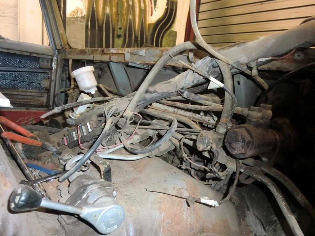

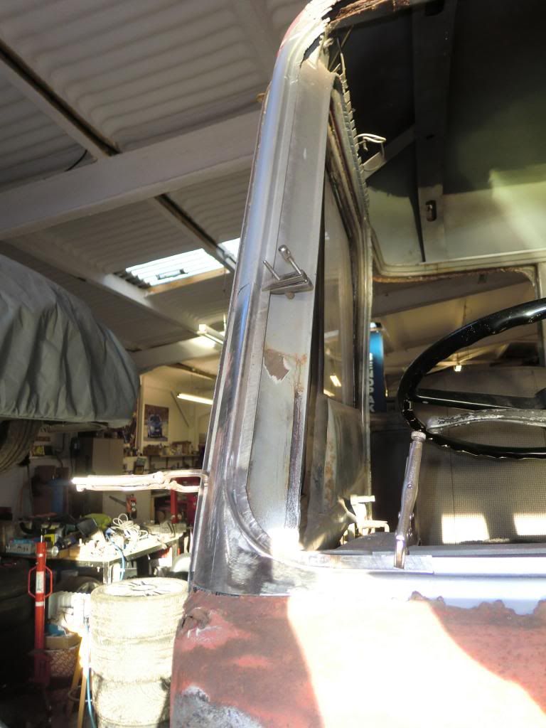

I,ve been doing some more work,The dash has been removed to get to the panel with the holes for the air vents and where the windscreen rubber goes,this is rottern and needs remaking.The cab loom has been taken out, also the windscreen wiper motor is burnt out so I need to sort a fresh one as it needs to go in before all the cab is bolted beck togeather.
With the photos that Gert sent me from the blue and white 86 that Leo Bols did I have been able to see how the windscreen lip is put togeather .I am making the windscreen pillers at the moment then the top of the cab will be tackled
I have had 2 windscreens made 1 to keep as a spare just in case £600 to supply and fit one inc the spare made to order.
Phil
