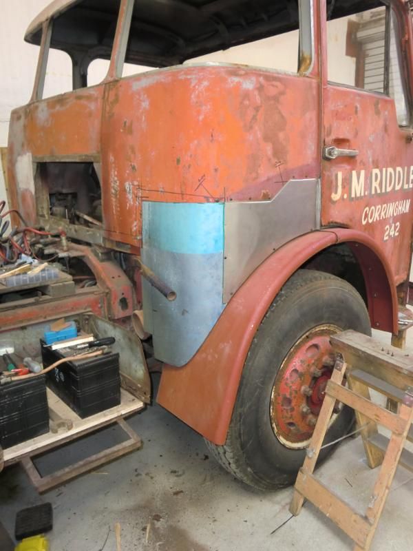

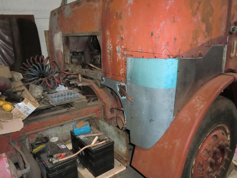

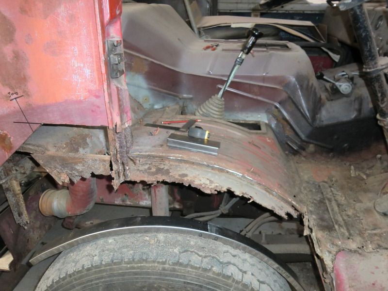

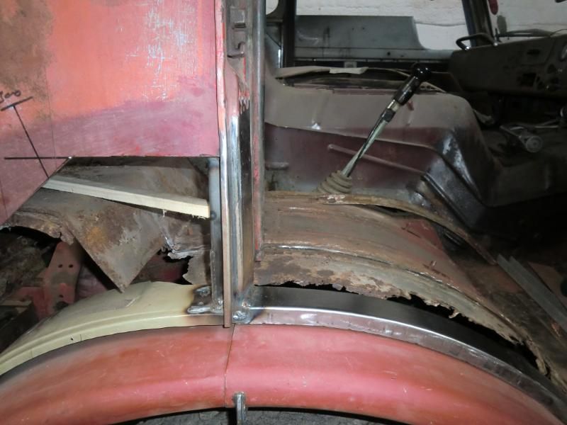

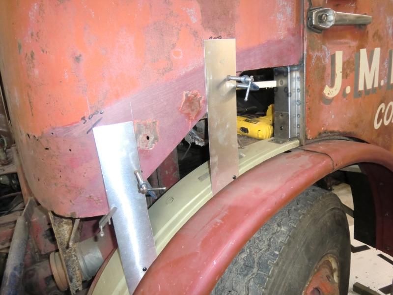

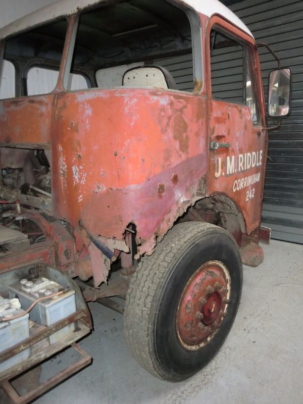

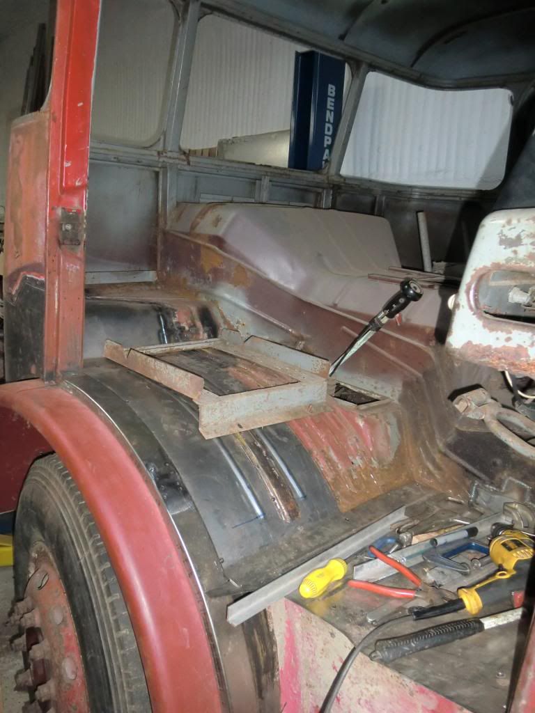

Hi I’ve been doing a bit more cutting and welding this time on the drivers side of the cab,I made the new curved part of the wheelarch then repaired the door piller,I had cut the rear section from the sixwheeler cab to use as the corner section because of the curved part of the cab.At the moment all the bits are held in place by selftapping screws as I have the cab floor to make and weld in place.So it looks a bit like a tin jigsaw at the moment here are the photos

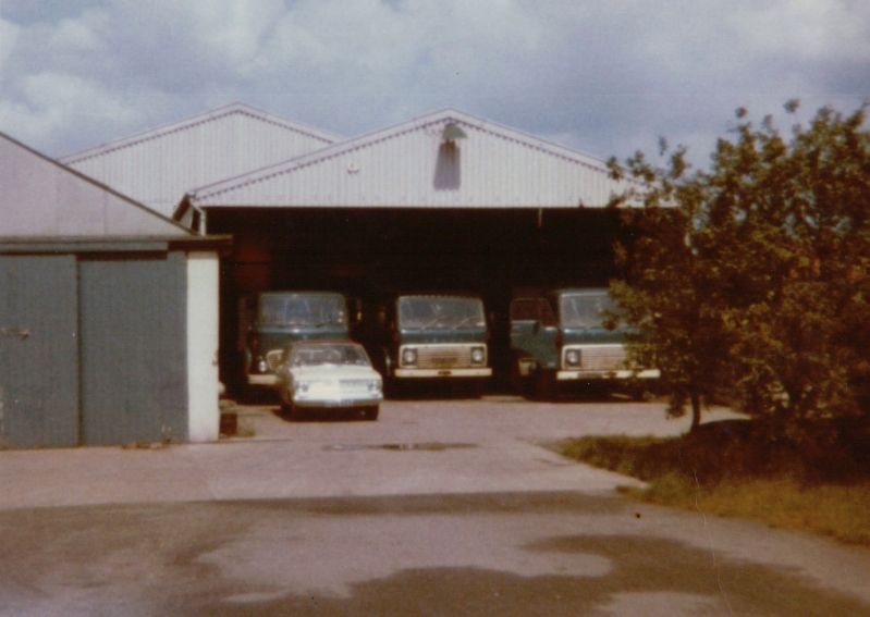

I have just finished moving house and came across this photo of our 2 86s and BMC 6 wheeler parked in the garage over spring bank holiday 1972

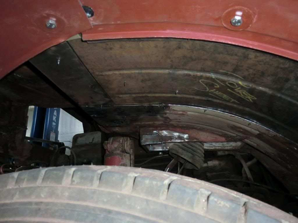

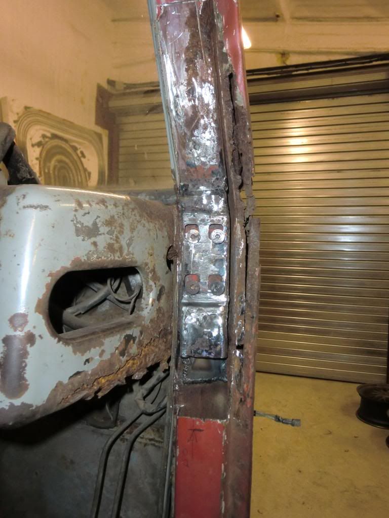

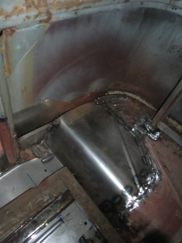

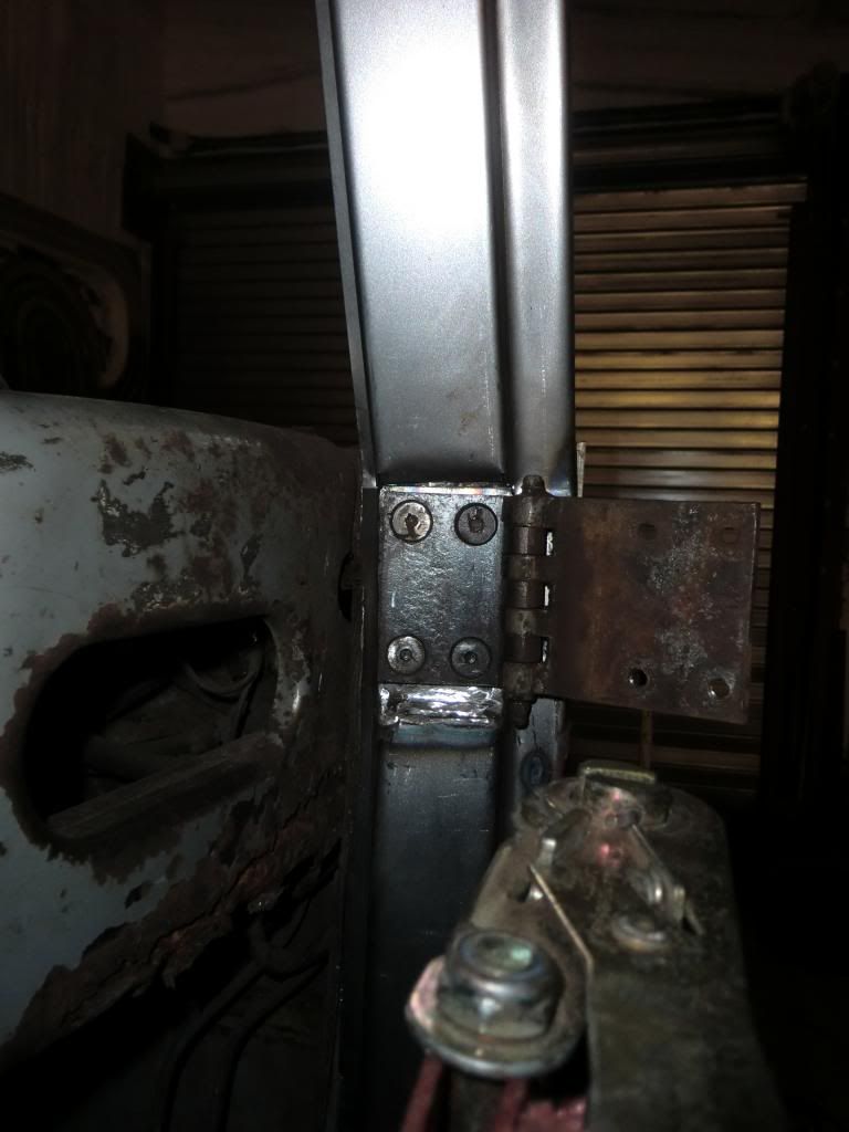

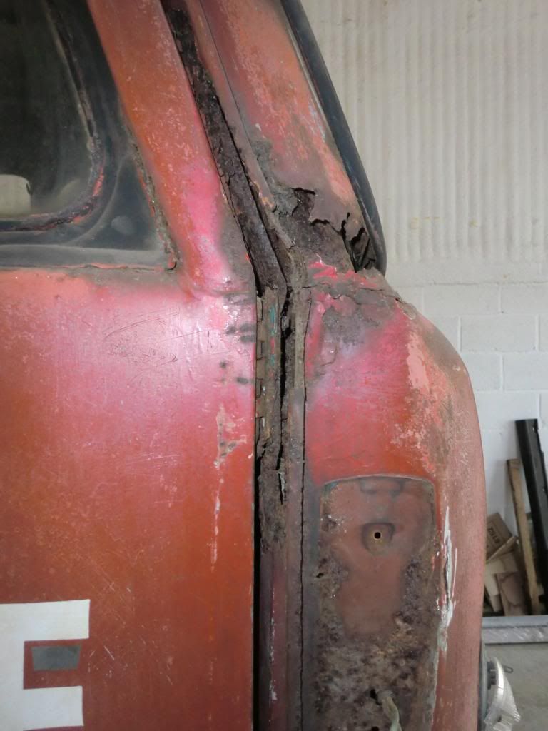

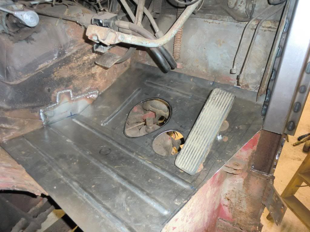

Here are some photos to bring you up to date,The drivers side of the cab was far worse than the other side so I have had to make a new floor panels for the rear behind the seat,the curved area down to the pedels and round the steering wheel base.The door piller has started to pull apart from the windscreen piller and the top hinge has had to be rebuilt.
