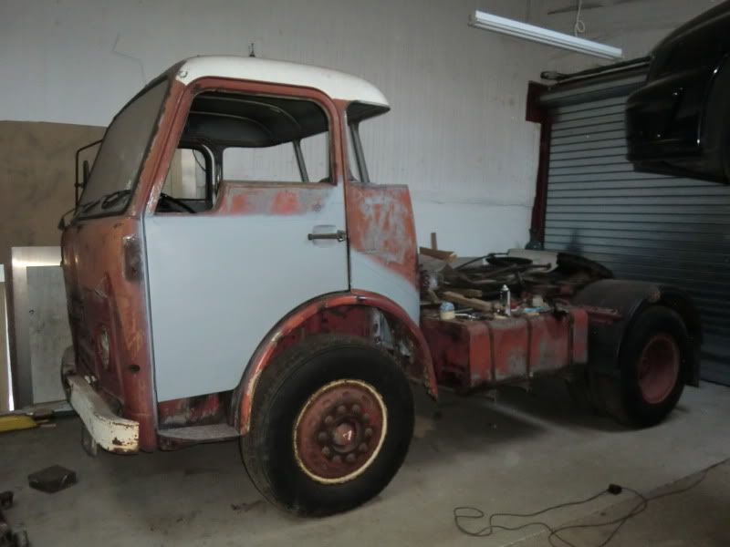

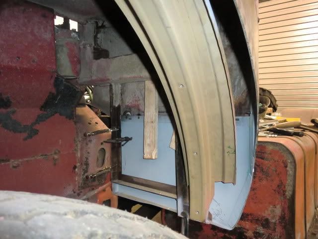

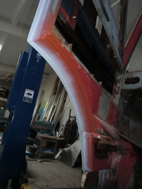

I got the rear of the cab welded up today and am very pleased with it the new part of the panel curves to the wheel arch as it should,I have just painted it with primer to stop the new metal rusting,I will get the hole cab shot blasted when the welding is finished
That was well done Philip!

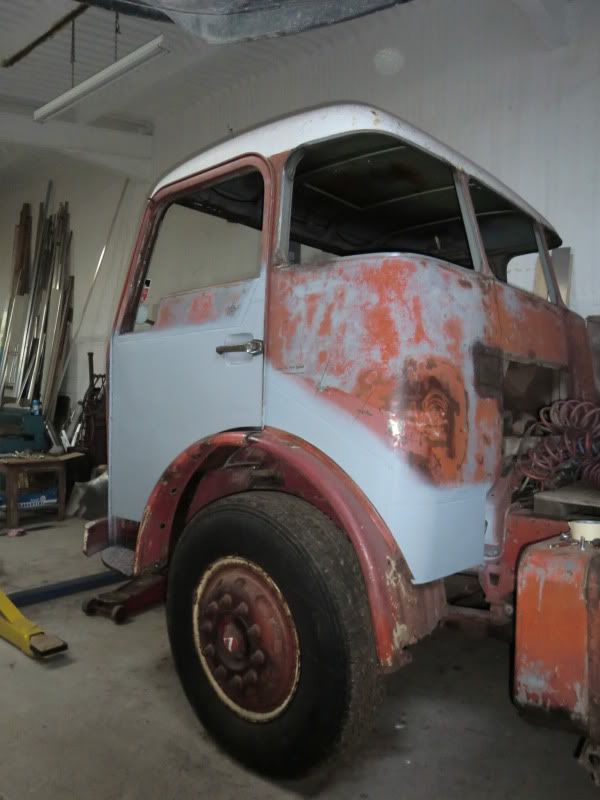

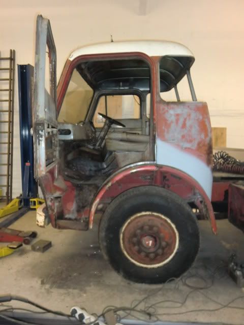

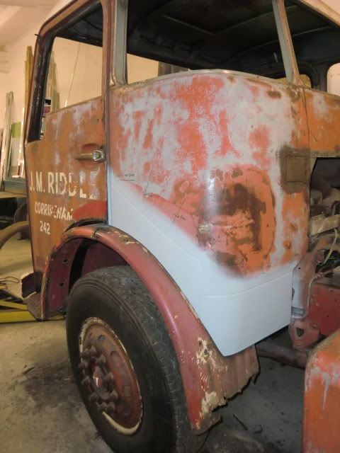

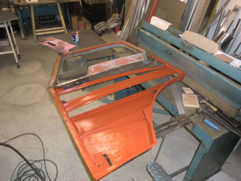

Hi I’ve done a bit more work on the truck,The passenger door, I got the 10 mm steel plate lazer cut to the size of the door panel then cut a peice of 20swg sheet 10 mm bigger than the steel then bent the edges down,
I cut the panel from the door the repaired the edge of the door then painted the frame before fitting the lower panel
I ran the panel through the english wheel to put some curve in both directions the crimped the edges and welded the top part of the panel
Then refitted it to the cab
So I think it looks abit better than when it first came

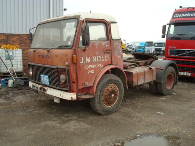

Thought this one was a tidy example.
4 Volvo badges thats just gready.I’ve done a bit more welding on the door but no photos yet .
will keep you posted as I go on.
Phil
Try 5 Volvo badges!!!
