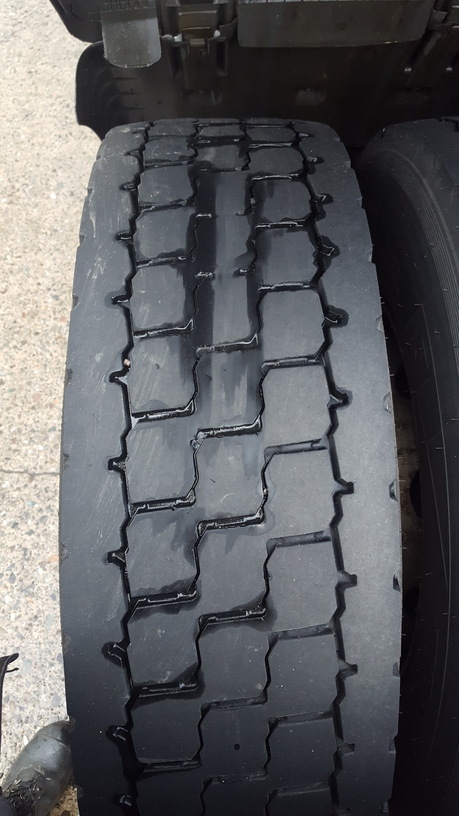

What’s the verdict. It’s a NEXT TREAD NT RHD. Not sure. Leaning towards illegal myself
looks like it needs a tread depth gauge on it… looks like its been over inflated looking at the depth differences between the inner and outer of the tyre…
Looks like it’s around a millimetre in the middle, can’t really tell very well but if I had that on mine I’d be getting it changed. Regs are 1mm minimum tread over 3/4 width all of the way round.
Looks legal but only just. I would want it changing if it was me.
Exactly so. You can`t guess, especially from a photo. But, iffy looking…
Looking at the photo it looks legal to me. If you want it changing you pay for it, I guess about £180 or £360 to make a pair.

It’s getting towards iffy I reckon, I’d be keeping a close eye on it, and getting it changed over at the next planned workshop time.

Yes, same for me. It’s not bad enough to warrant a full blown toys out of pram and refusal to take but I would want reassurance it being addressed was on the cards.

What counts as the tred area because if it was between those cubes then that would be 0mm between a couple of them but when recut the tyre guy misses out a few of them before cutting across from left to right. Confusion results.

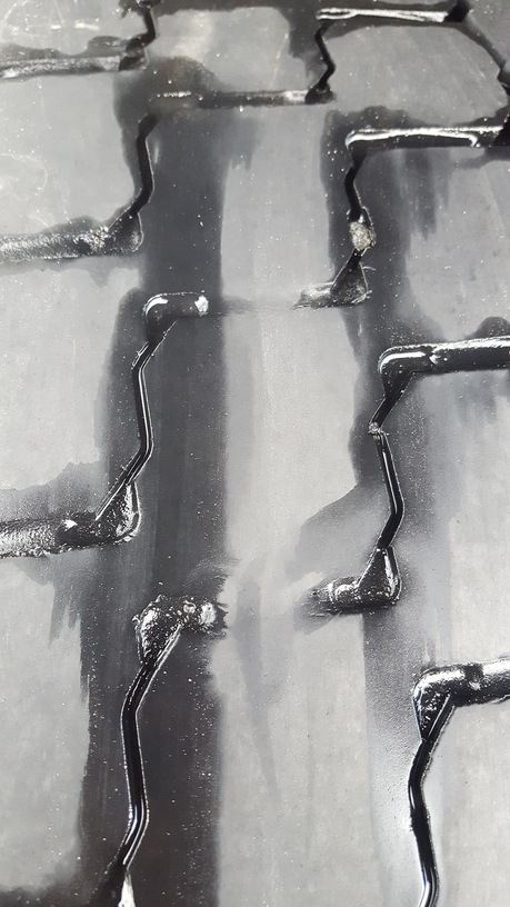

That doesn’t even look 1mm in the second photo, it looks smooth and it’s in the 75% zone aswell.
Shouldn’t be any confusion. 1mm across 3/4 width of the tyre, all the way around.
So if you have 4 lines of tread as per your tyre, 3 of them should be 1mm or more. Forget about your cubes they are irrelevant really.
I’d have concerns about the firm if they didn’t agree that this tyre needs changing! :open_mouth:

Going to need replacing very soon but still legal, its not quite on the wear stops.
There may be a few thin spots in the middle, but there is plenty of thread on 75% of the width of the tyre. Use a depth gauge, you’ll be surprised how little visible thread is actually 1mm… that looks like the majority of the thread will be about 3mm. Also no cuts or tears, generally looks like a tyre that has an easy life. I do agree it looks like it may have been run over inflated.

The tyre has been over inflated and will need changing. I usually scrap my car tyres at 3mm.
From what I can see on the second picture the tyre is illegal.
As has been said you must have 1mm minimum tread on 3/4 of the width of the tyre all the way around. Picture 2 appears to show a break in the original tread right in the centre - therefore there isn’t 3/4 of the width anymore. The original tread ran right across the tyre - it doesn’t now.

If I remember rightly the MOT manual says something about having to be able to see the base of the original tread. There’s a spot on picture 2 where it has gone
