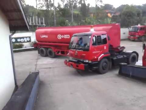

This type of thing :question:
Yes mate thats the one [emoji2962]
