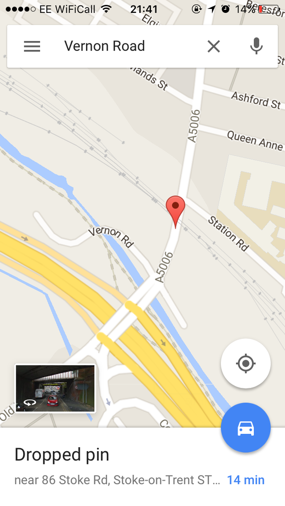

Bottom of Stoke road in Shelton,Stoke on Trent…I come out of Vernon road and if I’m heading into town my sat nav tells me to go left but there is a 13’3 bridge where the pin is and the settings in my sat nav are set @ 13’10
Cheers, just checked mine and it avoids the low bridge. Tried with 13.9 which is a bit different from 13"9’ tho
