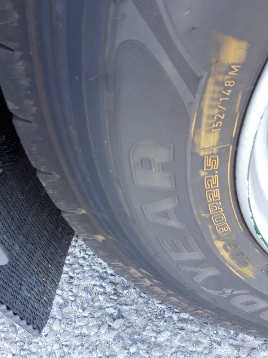

Why at services week checking they mark tyres??Why after services passengers seat seat belt connected to fastener.Any rulles to keep this all the time??
They plugged in the passenger seat belt to check it works ,the belt isn’t frayed and they will have checked it works…The tyres are to show they have been checked ie size and load rating etc the 152 /148 is very important if that is incorrect then it is a MOT fail,
and year of manufacturing
Swiping them with chalk makes it easier to read, mainly, and you know which ones have been checked.
