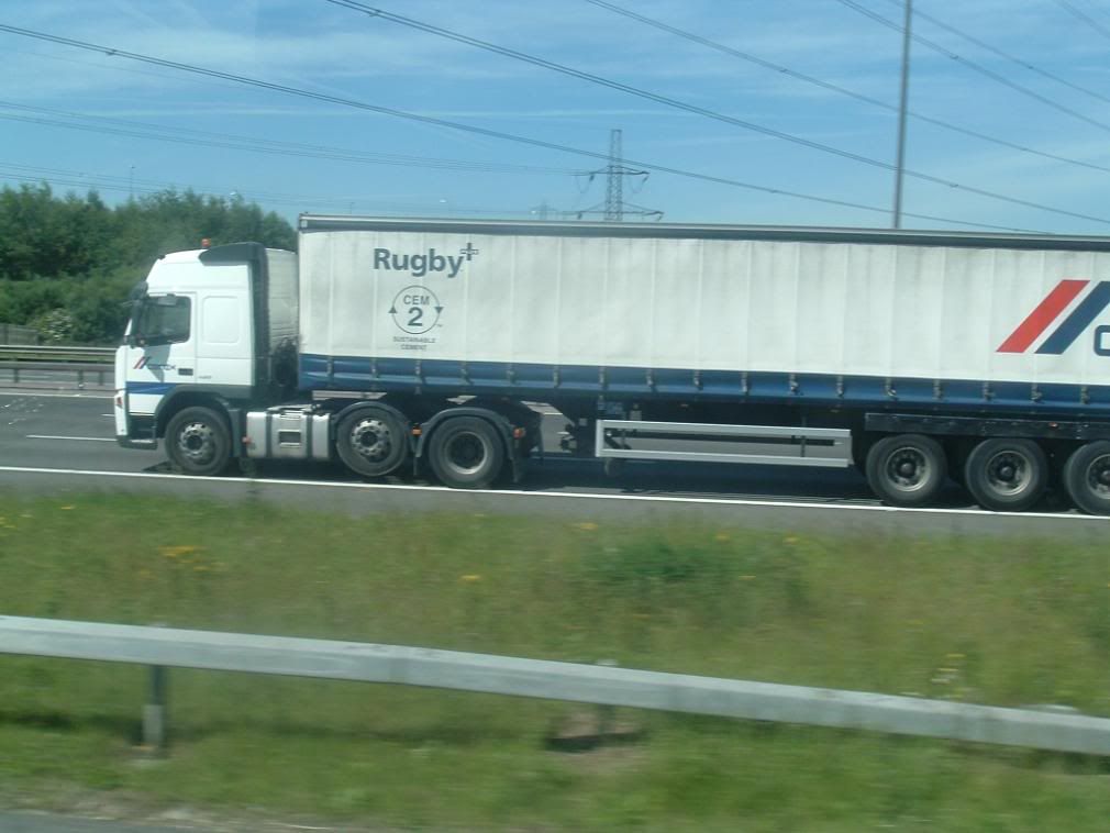

Took a picture of one this week
I’ve seen the fold away type legs before on short trailers and I seem to remember they were like that so the legs could be mounted further forward, therefore less chance of the trailer tipping up when being loaded. ?
