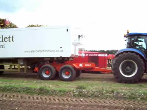

in good ground conditions as weeto says just about any unit will do the job but in damp / wet typical UK weather your going to need something better designed for the job . Look around for an old 200hp agricultural tractor with air brakes and a fifth wheel dolly .
In good conditions the tractor can help tow the lorries in and out of the fields .
in moderate conditions it can use the fifth wheel dolly to tow the trailers round the field .

Seen some farmers using the rear chassis only of a tractor unit hitched behind a decent sized normal farm tractor to pull artic trailers about, if you buy a complete tractor unit consider using the engine and gearbox already mounted in the front chassis for a stand alone PTO drive unit, one place i used to load regularly had a massive sucker blower (not many tractors would have coped with the thing) attached to a 250 ■■■■■■■ driving the blower through a David Brown gearbox, but could be used for all sorts of jobs requiring drive taht doesn’t stall out.
