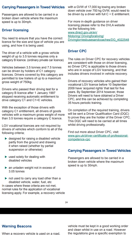

Would someone with an old class 2 with the 102 restriction ie drawbar trailors only,be able to hook up to a broken down artic and tow away,seems crackers if they can,but cant drive the artic combination on its own,but ok with a longer combiniation of the artic getting towed by say an 8 wheel wwrecker?
The licencing categories are broken down very simply :
C - Vehicle over 3,500kg MAM carrying no more than 8 passengers plus driver, with trailer up to 750kg
CE - Vehicle over 3,500kg MAM carrying no more than 8 passengers plus driver, with trailer over 750kg

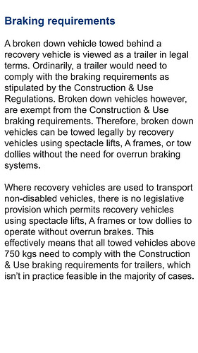

As well as you licence entitlement you also have to consider what type of trailer it is under the circumstances in which you are towing, spec lift, if it is over 750ks it needs to be braked unless it is considered unserviceable, broken down, you can’t just tow a perfectly good car/ vehicle over 750kg without the towing vehicle being able to operate the brakes of the trailer, towed vehicle,

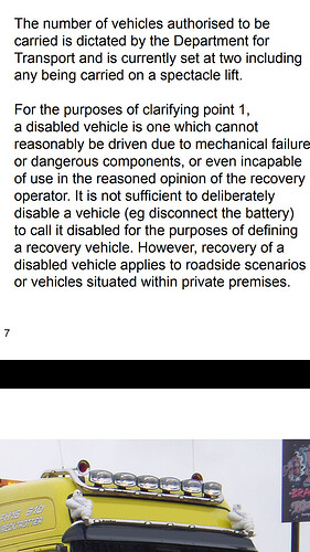

The exemption is for recovery vehicles, but that’s only carrying 2 cars, if you’ve more than 2 cars on I don’t see how you could then claim the recovery exemption

If you are worried, you could just book in for a C1+E course and test. They are reasonable priced and quite quick to do. I think it may also upgrade you to a B+E once you have passed as well which is always handy to have for caravanning etc. You could try claiming the cost back from your employer too :slight_smile:

It says a car on the spec is classed as a trailer and we know that trailers with a gross over 750kg needs to be braked, so unless you have a car that doesn’t have a gross over 750kg or it’s being recovered by a recovery vehicle, then you can’t use the spec legally

Need a C+E not C1+E to tow more than 750kg MAM with a C vehicle

Ive no expertise in this. Can we summarize where we are? The OP is talking about car transport, not recovery*. A car on a spec carrier is a trailer. It is also still a motor vehicle so needs tax insurance & MoT. Its weight will (99%) be over 750kg.
So a C+E licence is needed.
As it`s a trailer of over 750kg it also must be braked.
*(If it was recovery only two vehicles can be carried anyway, not his case)
