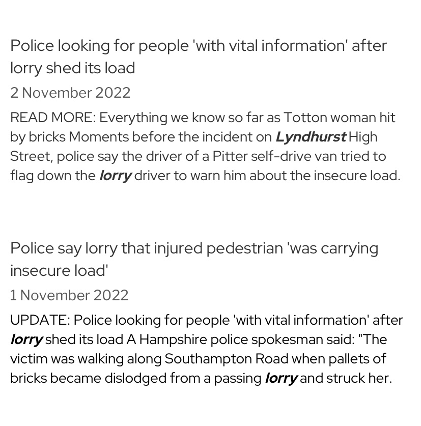

Time to bring back Nets?
Just a thought.
thesun.co.uk/news/20280341/ … uthampton/
What went wrong?
Guessing that each pack of blocks has a thick heat shrink plastic wrap and that in this case one was damaged/ripped/failed?
So, a net would have probably prevented the pack splitting out of it`s wrap, and falling as catastrophically as it did, agreed.
But, if the plastic wrap was in good nick, any net would be unnecessary.
I think we`re hoping to stop bad practise here.
Badly wrapped packs, and no net: refuse the pack.
So, no need for a net.
Badly wrapped packs, with a net: “Chuck it on it`ll be fine!”…
