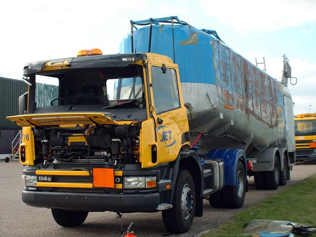

Just be careful with any tanker. Here is a one at an airport where I worked (it was my truck but I didn’t do it guvnor). Got called in for the clean up. Closed the airport for 5 hours. This happened on a truck governed to 15mph.

bowserman good post take it the driver was bored with the job :laughing:
knew it all :question:
done another look zbn hell what a ■■■■

scania245:
done another look zbn hell what a [zb]
The trailer used to have a 3 axle ERF under it and then the company put the new Scania in and if you look it does sit rather high. Interesting also to see the integrity of the lids!!!
