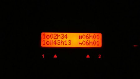

Heres a pic of mine and if you want to know your fortnightly drive, look at your bottom left of the screen.
As you can see from mine, my total drive for the 2 weeks so far is 43.13

In some lorries ive driven this 43.13 hr driving(2 weeks) is shown as 999h9 but on poa. Maybe op is meaning this?
It says 999h9 when i am driving, then when i come to a stationary position it changes back to the right driving time for 2 weeks, which is 35hrs.
So when the wagon is moving it says 999h9 at the bottom left, then it changes back to normal when i am parked up.

Does it definitely have a 1 in front of the driving or POA symbol when it’s showing all the 9s ?

No it has a 2 and a symbol beside all the 9s.

That’s not your info. It’s for the 2nd drivers slot.

Ahh ok. Got ya.
When im driving that info comes up,then when i park up it goes back to normal.
Sent from my SM-G920F using Tapatalk
The drivers information will have a 1 in front of it, as has been said the 2 is the information for slot 2.
It’s been a while since I used a digital tachograph but from memory, on a VDO tachograph to see the drivers information you press OK when the vehicle is moving, or press the down arrow when the vehicle is stationary.
