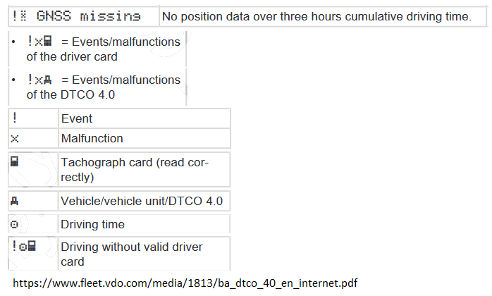

What does the top three lines refer to, on the bottom of the Gen 2 printout please?
I think it means (and states when and for how long) the vehicle has been driven without a card inserted.
Hopefully someone can confirm.
stu675:
I think it means (and states when and for how long) the vehicle has been driven without a card inserted.Hopefully someone can confirm.
Wait… 7hrs and 18 mins driven without a card?..oh well, that was a thought wasted
Loads of info online about tacho symbols, try either of these links below.
But basically if it’s on the bottom of the print out, don’t worry about it, none of it will come back to bite you, usually it’s just people moving the wagons in the yard without a card in, no big deal unless they rack up more than 5km
https://www.fleet.vdo.com/media/1813/ba_dtco_40_en_internet.pdf:
I.e. The GPS in the tachograph isn’t/wasn’t working.
(It says “No position data over three hours ■■■■■■■■■■ driving time” but it also logs position at the “start and end of
working time”.)
