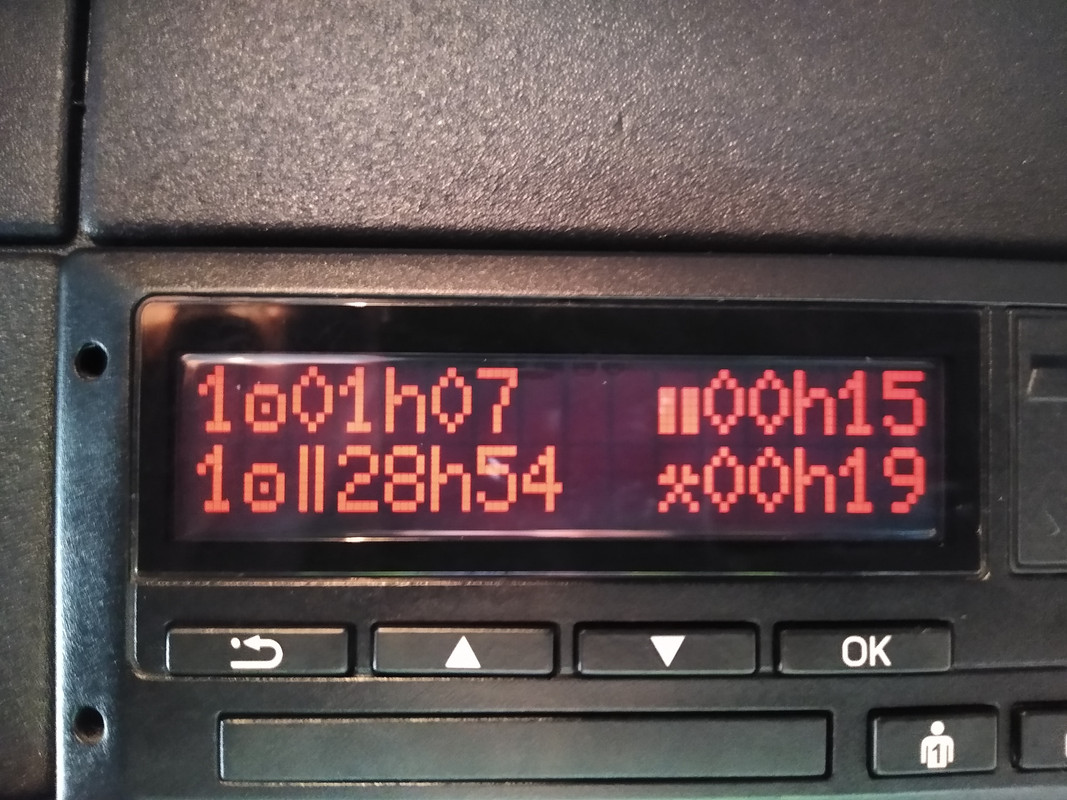

PaddyTheLorryDriver:
I screwed up my first go at manual entry and it thought I done other work for 28hrs
IMG-20220916-105512544
Told not to bother anymore and just pop my card in at the start. I always get there 10nin early and so my cards in at start time, takes about 2 min to get out and download my card at the end each day.
You still must record your rest period though though, so unless you’re doing it on a printout you’re not compliant.
And that’s poor from a company to tell you not to bother rather than show you.
Didn’t see the pic to start with, that’s not 28 hours of other work, that’s your 2 week driving time
