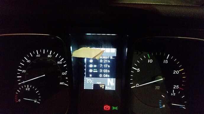

Tacho puzzler
I could be setting myself up here to look really stupid :blush: :laughing:
But forgive me if I’ve missed something really obvious here, or got something easy bloody wrong…it’s my first day back after 16 days off :smiley:
Anyway, been a bit of a funny day, did not start to late, only done 3 hours 3 minutes driving total (verified on printout) most time has been spent waiting, and I’m parked up as load not ready to morning.
But …on my tacho display on dashboard it is showing 7 hrs 17 min on display, but the correct amount 3hrs 3min on weekly driving so far, and 21mins (also correct) since break.
Anybody throw any light on the 7hrs 17 ■■ :neutral_face:
Surname covered to protect the innocent. :laughing:
Could it be the amount of driving time available before an overnight break?
eurotrans:
No, that section 2nd reading down tells you how long you’ve driven for that day…so both sections (daily and week totals) should read 3 03 with being my first day of the week.
My minds gone blank mate, I think I’m right saying that,…I’ve been off too bloody long, I can’t even remember if that’s correct or not. :sunglasses: . :smiley:
Think it’s showing my lack of interest in tachos…and the job in general. :smiley:
It’s a Merc Actros btw. enough to make anyone lose ■■■■ interest. :laughing:
What’s the tacho head say the same or different?
Did you do a manual entry and ■■■■ it up therfore it’s added your last driving period plus today’s together, although it would have been flashing break at 4 and a half hours like mad if that was the case.
simcor:
Well firstly I have not done 4 and half hours continuous OR total, so it did not flash up for a break…although I did book a 45.
Secondly I never do manual entries (well not of that type anyway :laughing: ) so no again. :neutral_face:
That rules that out then.
I Know you haven’t done 4.5 hrs driving but I’ve done it before and messed up a manual entry. So it looks like you haven’t had a daily rest and it adds the last amount of driving time and whatever you have driven together, but as I said it would have been flashing like mad at 4.5 hrs.
And as you don’t so manual entries then it isn’t that.
Time from start of shift/put your card in?
Started this morning, it had cleared it’s self, and is showing the correct reading of 3h 3m weekly driving so far…no mention of the 7h+ .
Remains a mystery…not particularly bothered btw, but curious.
