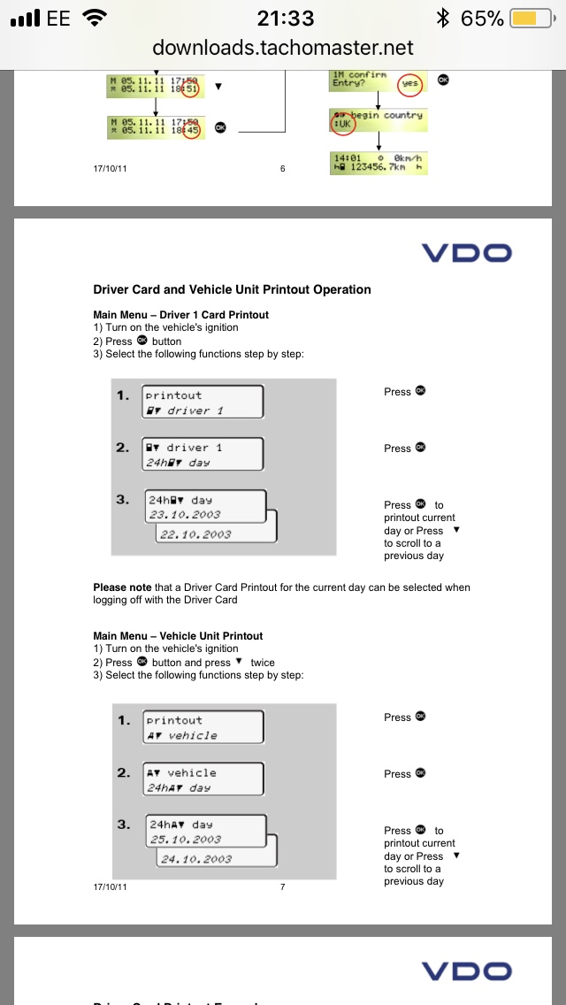

Is there a way of printing out a shift from say 3 or 4 days ago, from the vehicle tacho, not the office computer
Yes,when the date comes up on the tacho head knock it back to the date you require then print.

It can be done from any vehicle

I didn’t say you said you couldn’t I was just agreeing and pointing out it can be done from any vehicle with a digi tachograph ![]()
Also bear in mind that if the shift went past midnight you’ll need to do two printouts - one for each day. This is not quite the same as when accepting the offered printout which will normally cover the whole shift in one print.
