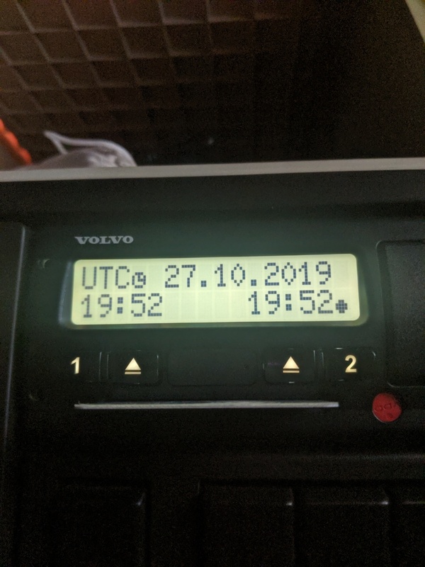

Just change the timezone on the tacho to GMT and all shall be sorted. Unless you have an older truck then the trucks time will need changing separately.
Only thing to watch is some tachos do half hour timezones so it could be “GMT + 30” which can be confusing when you’re looking at the clock.
As mentioned internally it always runs one timezone but display time is different.
Like this
