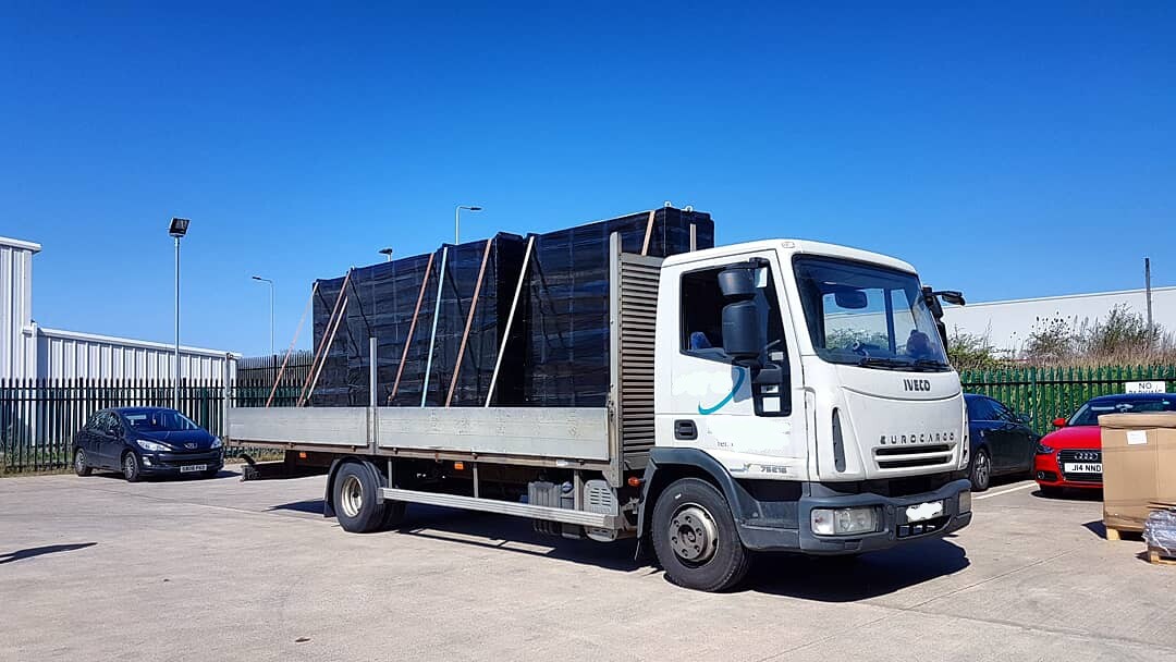

Sounds like an electrical enclosure which is what my old company manufactured and I delivered.
It’s perfectly okay to feed the strap through the eye bolts so it doesn’t damage the panel, see the photo I attached.
That’s how I delivered them everyday for over a year and had no problems.
