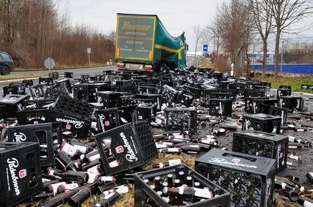

Paderborn. Yesterday.
The Polizei suspect that the load was not correctly secured or the driver may have been a little too enthusiastic with the right boot when cornering. :sunglasses:
Gerraway :exclamation: :exclamation:
Guy hadn’t even got 5 klicks from the brewery… :blush: :blush: :blush:
Food for thought, methinks…

I tried to think of a comment to add to brit pete and Inselaffe’s for this, but it seems to speak for itself…
I’d like to know the outcome for the driver and his/her boss though… :wink:
To quote a yet to be born Scottish gentleman: “Ye cannae change the laws of physics, Jim” :exclamation: :exclamation:
If a load ain’t suitably strapped down or restrained in some other manner, it will go pear shaped one day :exclamation:
That Newton fellow and his pesky “Laws of Motion” :sunglasses: :sunglasses: :exclamation: :exclamation:
