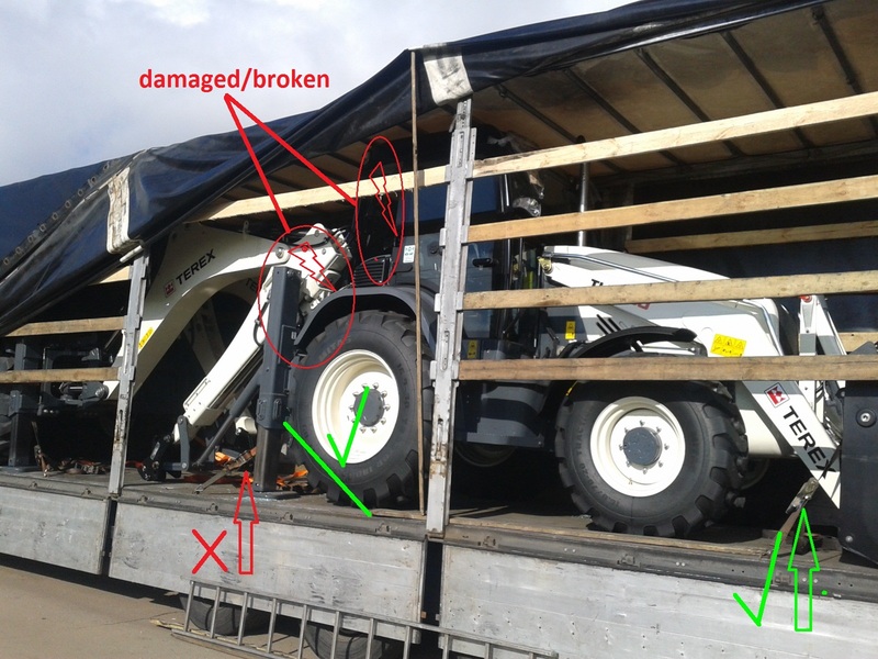

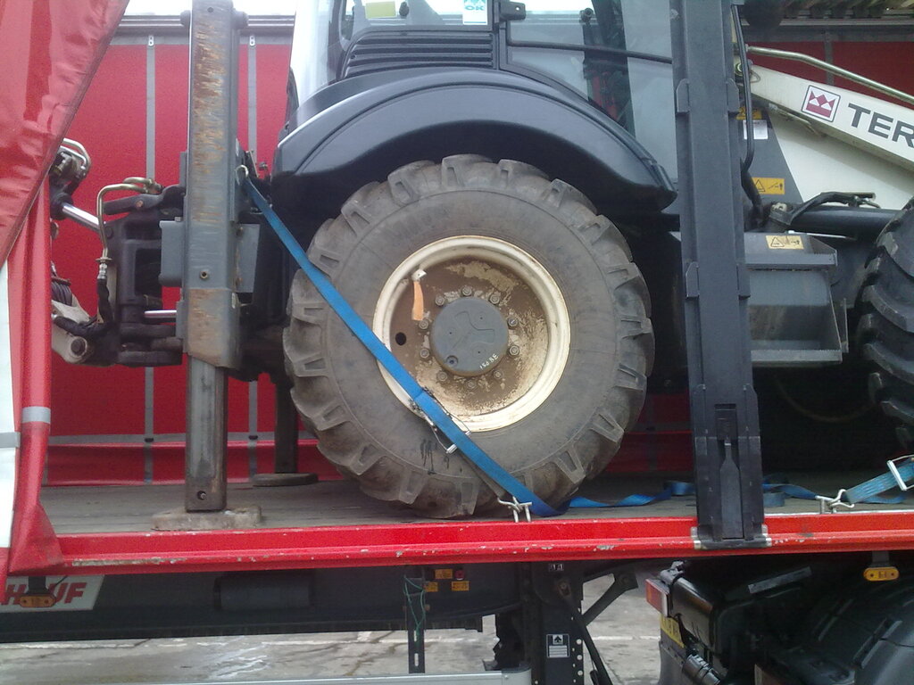

despite showing them photos, sometimes doing it for them , pointing out the lashing points, you I still get this kind of rubbish happening. top photo is how the vehicle arrived in Moscow, rear backhoe had all the straps pulling it forward instead of stopping it from moving forward or backwards, consequently , he braked and the backhoe didn’t . the next 2 photos just a complete dogs dinner, straps going everywhere , including going under the front axle and pulling the machine off the deck. I have actually had 1 geezer who wasn’t going to strap either backhoe at all , destination - Moscow.

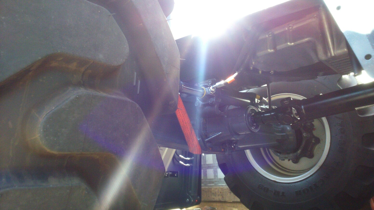

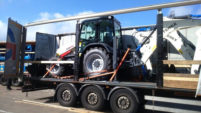

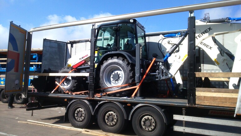

there are 4 good lashing points on these , at the top of the stab legs , and behind the front loader bucket. there’s also 2 more lashing points at the bottom of the stab legs ( good for chains if you feel the need) and also 2 more on the chassis near the front axle ( these aren’t big enough to put a hook straight on , but you can thread a chain or strap through them)the last 2 photos show these lashing points in use on curtainsider trailers.
I’m not saying this is the definitive way to strap a backhoe onto a trailer and lots will say ‘gotta use chains’ or have other ideas, but , this is tried and tested over the last few years, and so far nobody who uses this method has damaged or lost anything and we send these things out all over Europe any further and they’re stuffed in to a container. same method applies to when they’re loader on the usual semi low loaders for uk work.
