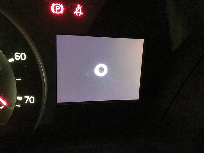

Had this when starting today it’s like a kind of buffering icon wheel on the right side of the dash and also on the infotainment screen, I turned the battery off then on and played around but couldn’t clear it any ideas anyone ■■
Try knocking off thr batteries (should have an isolator switch somewhere) did the trick when I had the same issue. ![]()

I did turn the battery/isolator off but still nothing.

Sorry no solution here, but has all radio etc failed?

Had this when starting today it’s like a kind of buffering icon wheel on the right side of the dash and also on the infotainment screen, I turned the battery off then on and played around but couldn’t clear it any ideas anyone ■■0.
I’ve had this a couple of times. Just leave it and it usually sorts itself out later in the day.

Sorry no solution here, but has all radio etc failed?Sent from my SM-G361F using Tapatalk
Got to be honest I didn’t actually try the radio I put a defect in and grabbed another unit but I’ve never seen that before I’m guessing a software glitch.
I had something similar to this on a 17 plate FH4 , Volvo told me to…
Close all windows and doors
Turn off ignition and remove key
Press hazard lights switch
Let it flash a couple of times
Hold down hazard light switch until handbrake light goes off on dash
Then go and have a brew for 10 minutes or so
I did all this thinking " ■■■■■■■■ winding me up "
But it worked and the infotainment system was up and running again !

Could be a new screen my mate had similar

I had something similar to this on a 17 plate FH4 , Volvo told me to…Close all windows and doors
Then go and have a brew for 10 minutes or soI did all this thinking " [zb] winding me up "
No need to do all that just press hazards let it out them hold it in with ignition on first click. You will hear relay reset job done.
Cheers, I’ll try that next time
