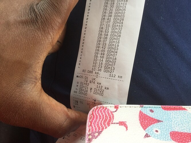

Thanks for the replies guys. Here is a printout for today. Notice at the bottom the break time says 5hr 28. I have had only 27 min break at time of picture. When i put my card in the morning and it asks me," rest until now?" i usually press yes so i dont think i have unaccounted time. Micks said maybe its the time i started work but in this case i started at 06:00hrs

Remember we’re using BST and the tacho will still be UTC time so you have registered 5 hours 1 minute rest before inserting your card (midnight to 05:01 UTC when you inserted your card) the the next 27 minutes is where you have selected rest during your shift.
If you didn’t select ‘rest until now’ and made a manual entry when inserting your card then instead of the rest symbol the 5 hours 1 minute would be recorded as a ? Instead (providing you used this mode when doing the manual entry)

Thanks Micks, I totally get it now. Can’t believe it was as simple as that yet here I was thinking the tachograph was broken

You have registered rest from Midnight until 0501 utc, by selecting YES on the rest untl now screen. If you look at your printout, the ? is against 0000, this means you have no unaccounted for time.
I think a lot of people don’t realise these print outs are midnight to midnight - so this print out shows the rest you’ve had since midnight. The other part of that rest period will be on a print out for the previous date.
