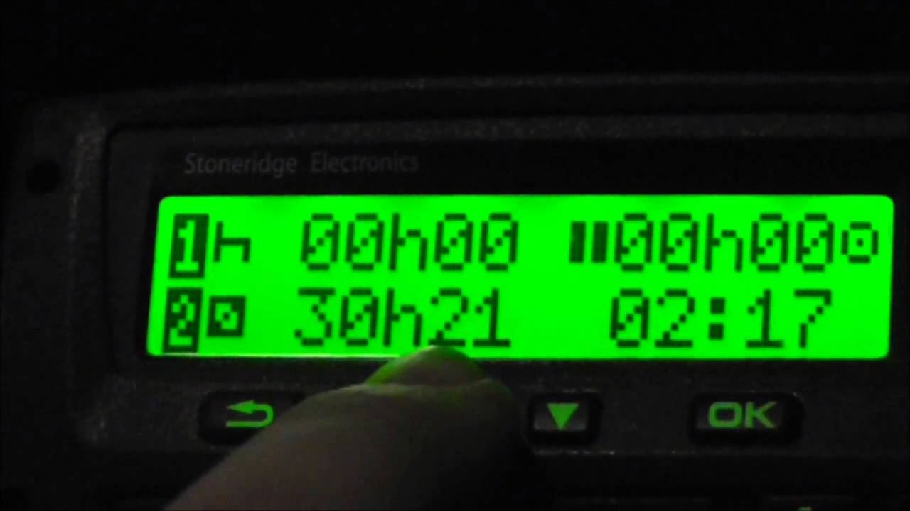

At the moment im at a place that uses stoneridge tachos. A couple of issues seem to of arisen.
when doing manual entry there is an option for end shift it then asks the country i finished in (fair enough) It then says begin shift and lets me enter the time i started the new shift and then any other remaining time (other work). however the issue is it seems to add huge dollops of other work (it seemed to add 30 odd hours last night). At last look it said i was on 97 hours other work. Should i not be using begin and end shift?
Second question is when i had my break it counted down from 15 but stopped at 0. then second break it counted down from 30 and stopped at 0 luckily both times i knew what time i had started my break so was able to add the extra on to make sure it registered. Is there a way of making count properly
From memory, just push the down button and it will display how many minutes of break you are on.

@franglais that video was helpful it is how i have been doing the manual entries as i have to walk back to the office and hand keys in and download my card after ejecting it and also get the keys and walk to the vehicle and put card in etc at the beginning of the next shift
