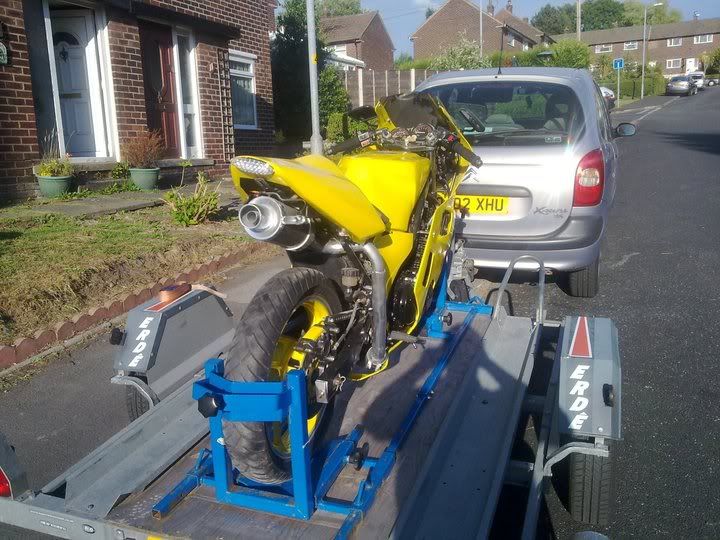

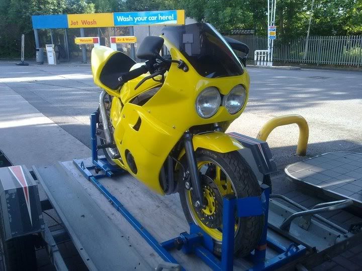

Friend of mine had this amazing clamping system, was in a van, then we put it on a trailer.
I’ve put a couple of pics on it, but as you can see, an ingenious design for transporting bikes in good condition without putting any strain on the suspension or fork seals etc.
Probably no use for crashed bikes though.
See, the clamps push down on the top of the wheel as well as pushing them towards each other, and the clamp at the bottom of the front wheel is adjustable for different width front wheels.
Only change I’d have made (before it got nicked :imp: ) would be to put a bit of protection on that clamp at the bottom of the front as it could chip paint off some rims. A 1cm rubber strip would’ve been perfect.

waynedl:
I love the terms ‘Ingenious’ and ‘amazing’ bike carrier mate, but we tend to use the term ‘industry standard’ :laughing: .
Our bike trailer drops flat onto the floor, so the bike gets wheeled onto it without a ramp, the front wheel sits into the dyna-cycler as shown above, the back gets clamped onto the back wheel and then the whole trailer lifts up off the floor for towing.
You can put accident damaged bikes on it, providing the front wheel can be turned straight.
We also carry bike wheel clamps and frames on all our spec lifts, so they can carry bikes of any size, and carry dyna-cyclers on the flatbeds so they can carry any bike.
Pretty much the whole fleet can carry bikes properly.
We contract to Carole Nash, Footman James and Bikesure, to name a few.
EDIT: This isn’t my vid but it’s the same trailer: youtu.be/ILajMExVY5Q
You still need to strap them on mind.
cieranc:
waynedl:
I love the terms ‘Ingenious’ and ‘amazing’ bike carrier mate, but we tend to use the term ‘industry standard’.
The reason I put about that being amazing is it’s a private owned 1 for our own use, not an industry 1. Was pointing it out because a lot of people just strap bikes down which puts oil seals under a lot of pressure (can blow them) and doesn’t do the shocks any favours.
I’ve not been in recovery for over 5yrs, but we just strapped bikes down back then, obviously times change as people see an oppertunity to earn, 1st time I saw a decent system was a Carole Nash recovery operative with a system like we had, and was well impressed.
Also, if you look at the one in my pics, you’ll see that NO straps are required, because it’s angled down on the tyres at front and rear, no amount of bouncing or anything would budge it.
Ahh I see your point.
Privately owned but still available to buy from all the regular recovery sellers, Recovery World, Cardno and RED all sell them :wink:
