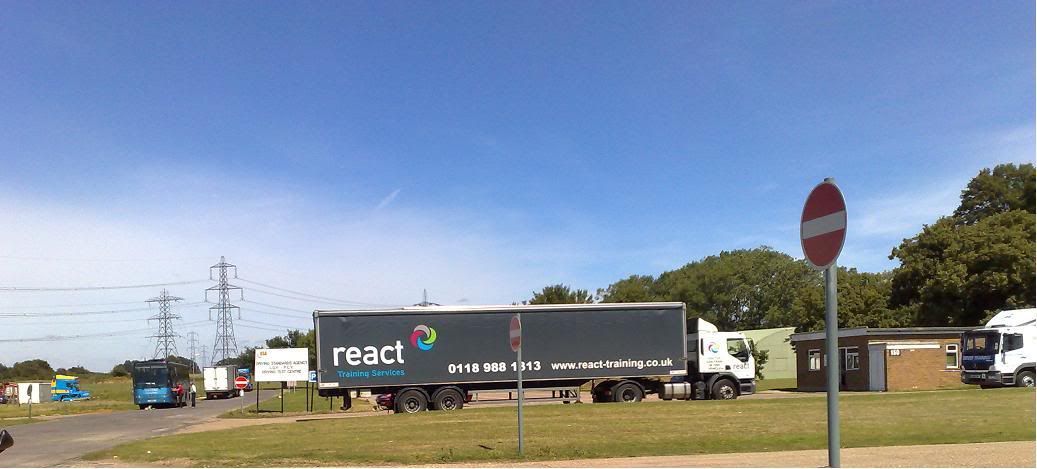

You got it, whatever you turn up for the test in (if you pitch up with a rigid and drawbar for example), you’ve got to show how to couple and uncouple safely.
Don’t worry about it, just do it the way you’ve been shown. I didn’t even know what I was doing at the time was considered ā€œsplit couplingā€ it wasn’t even mentioned. It was clear that there was no room to get in there, so it had to be done this way.
Here was the truck I passed in;
Just to show why the split couple was necessary.
