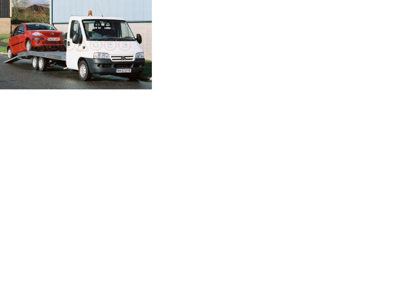

something like this?
carpages.co.uk/citroen/citro … _11_02.asp
will 1500kg be enough payload?

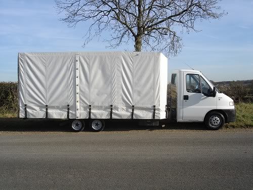

Thanks for the replies, the stuff is on the right lines, but the vans I’ve seen are enclosed and the rear wheels have a very wide track, which means a very low deck height between. Belle coachworks is a good call, but I wanted a picture to show the boss first.
Better?

Better?
Yea :smiley: something like that but with solid sides, but I could show that boss that picture and he’d get idea.
Perhaps like this, but with an extra axle and IIRC somewhat wider?
the open ones are better…lower unladen weight.
