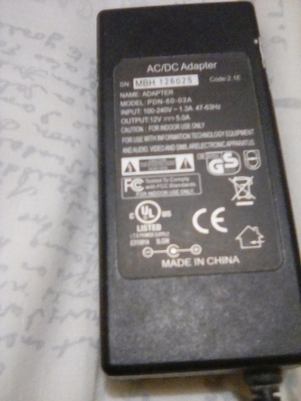

Regarding tv,most of them are actually 12v anyway .there is a dropper /tranformer, call it what you will in the power lead .you just need the correct lead to plug straight into ciggie socket
Just buy a normal TV and use an inverter, far cheaper than the 24v tv’s
