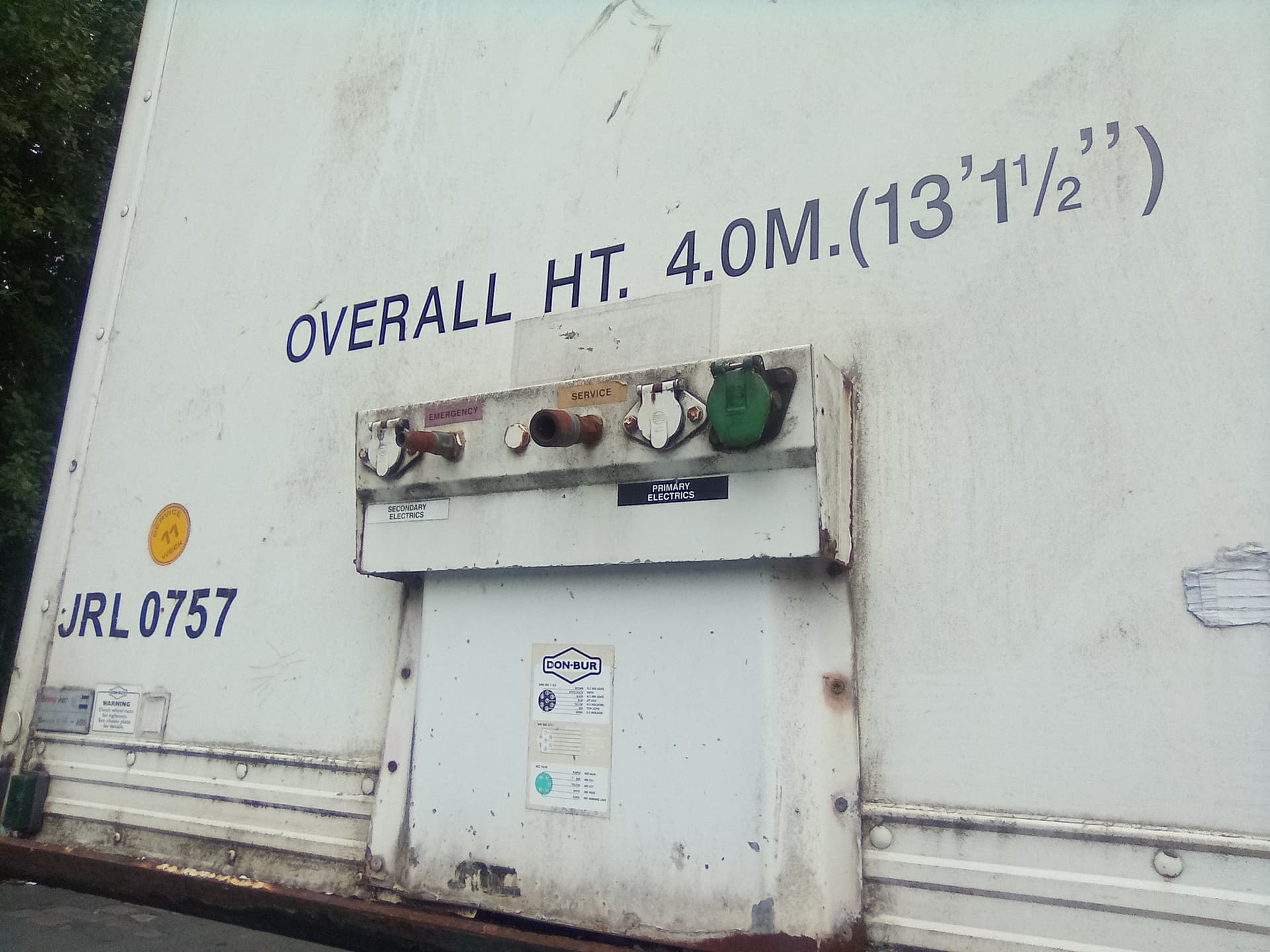

It’s about 4 or 5 bar to release the brakes I’d say. You’ll need an airline and coupling.

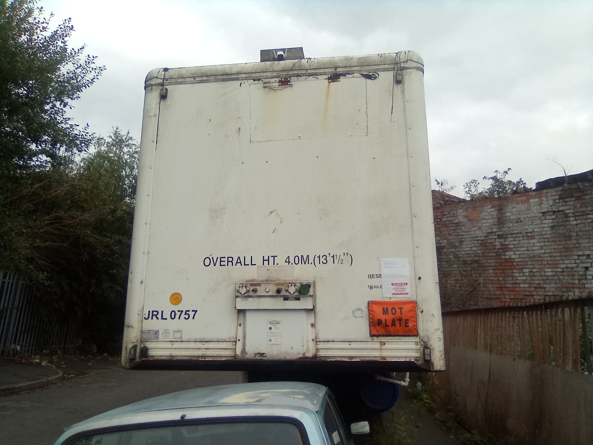

Oh well turns out the pin on the trailer is 5 1/2’ from the pin to the front of the trailer, and the folks of the FLT we have are only 6’ long. Best try something ells

Truck brake systems don’t operate at enormous pressures, modern trailers work at about 140psi, older ones at 115psi. About 80psi should be enough to release the spring brakes with the black shunt valve. Almost any small wheeled compressor is capable of doing it. Any commercial motor factor will have a male red line air suzie coupling on the shelf for a few quid.

I have uploaded a couple of photos
Thanks

If that old ■■■■■■■ is on discs and has been parked up for two years the forklift will be doing a nosedive trying to move that. ![]()
