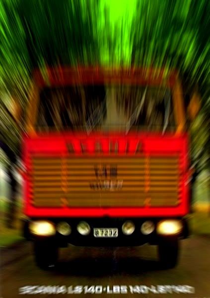

blur.

Harry looks like he’s at warp factor 10 with that last pic!
