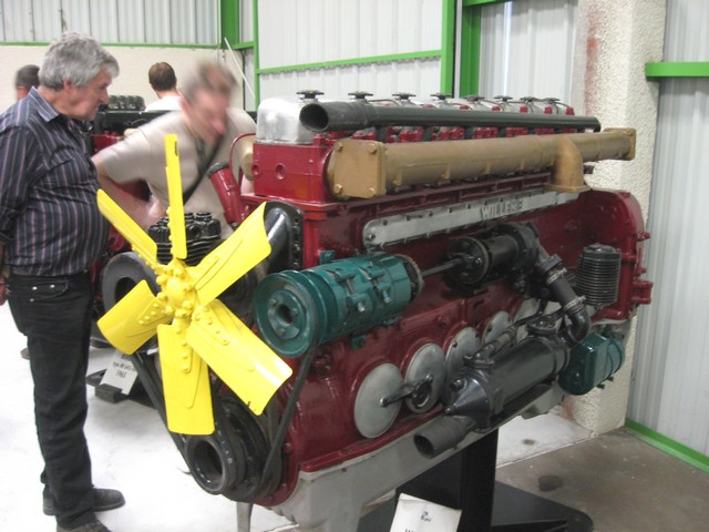

![010 032 [800x600].jpg](https://europe1.discourse-cdn.com/flex013/uploads/trucknetuk/original/3X/1/0/10b5759f52c1b25a2311c92f9504c447e39aff57.jpeg)
