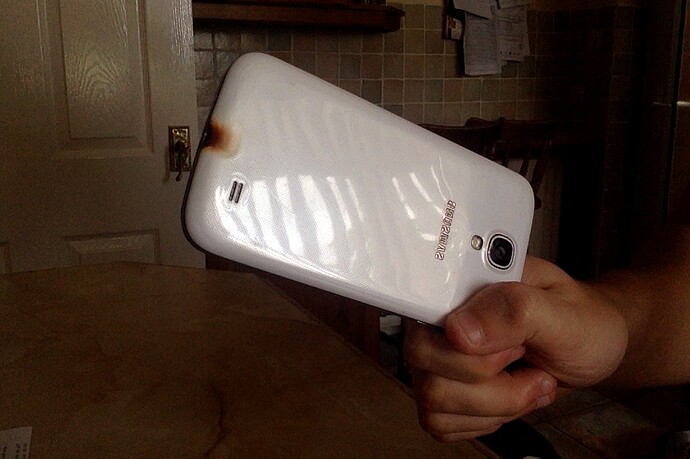

woke up in the middle of the night to a burning smell and the charger being fused to the phone! After reading reports this is a fairly common issue and if left the phone can burst into flames! taken it to Vodafone and they think it should come under warranty. I wish i’d never left apple, this is just one of many issues with my phone and its not even 12 months old.

Going by what can see in the photo, it doesn’t look like a battery problem but a charging port/micro usb connector fault as the charging port is at the bottom on a separate pcb from the main board and not connected directly to the battery.
I’ve seen it before on phones/tablets where the pcb/port/cable has been damaged by the phone being dropped with the charger/data cable connected or excessive pressure applied whilst inserting/removing the cable (they are that weak you may not have known you did it) causing a short circuit or failure to charge.
In some cases the cable/connector used for charging has been inadequate (usually cheap non genuine) due to the wires/connections being too thin/poor quality to carry 2 amps and get hot.
This problem isn’t unique to samsung but every device that uses a micro usb connection which in my opinion are not durable enough for daily use, although your issue may be caused by a manufacturing defect given the age I reckon that it will more than likely be caused by the above.
Your phone should still be covered by warranty they will more than likely repair/replace it.
If it’s not covered for any reason and there isn’t further damage, the repair should be cheap and quick as parts are readily available for these phones.

the one in d picture is a usb fault. I would not leave a phone plugged in all night as this could happen with any device that uses a usb plug
