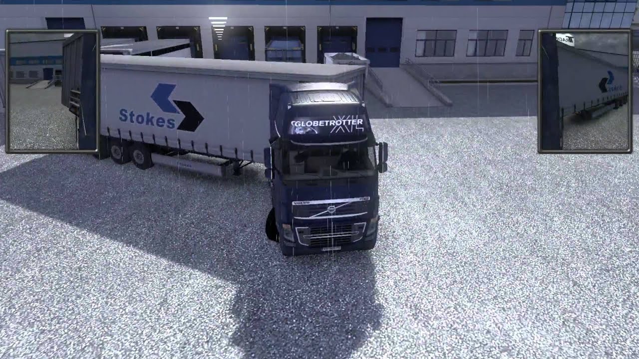

If you can see Volvo’s bonnet sticking out, another 4 cars next to it, I had no idea how to straighten the cab as it would ram the parked cars. Bloke at Poundworld said regular drivers do it fine, but how does one connect tail lift cable with tiled cab, it’s still a mystery.
When on shop deliveries obtain a second Anderson lead, or whatever lead connects the tail lift, that way you can park at any angle and still reach.
On one particular shop back door it was down a really steep ramp, the only way to level the trailer was to actually drop the thing on its knees, hence second Anderson lead to reach…those who didn’t do this (most) faced the real prospect of being swept off the trailer by several roller cages, sod that.
What you’ve done in the pic looks fine to me, i bet they’ve had trailers in twice as long as yours and 20ft high
