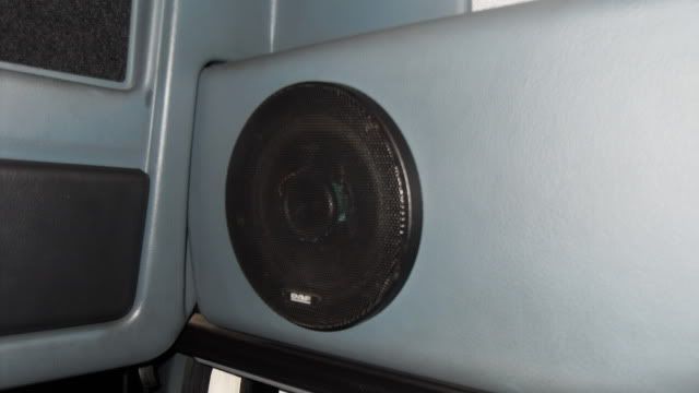

Here’s a pic
Harry, the hole in the center of the trim is 115mm
the screw holes are slightly oval shaped and are at 137mm centers
the max outer diameter of the speaker to fit in the trim is 150mm
