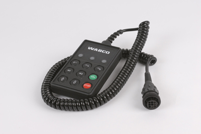

Anybody know the correct name for this thing? The panel on a curly cord that alters suspension and other things I mean.
Also, does anybody have a guide of what all the buttons do?

I thought all controls of that type are called ‘Wander leads’.
This is about the most common type of remote air suspension control.

If I was ordering the part I’d call it an ECAS pad/control unit which is it’s technical name (Electronically Controlled Air Suspension).
50/50 the parts department will know what you mean - so usually suspension control pad and people will know what you mean.

I’ve set my M1 button for the lowest setting, so as soon as I want to unload I just hit M1 and it will sit down so that the rear legs just touch the ground when I lower my ramps.
M2 is full height, handy for stopping the beavertail scraping on weighbridges and steep ramps etc.
