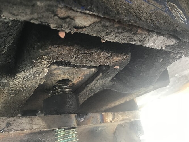

Anyone know if on a positive steer it’s just the 2 m12 bolts holding the wedge to the front turntable or have I missed something,just trying to free it up as it needs a forklift to pull 5 th wheel handle out
Hi Dan. I get the same problem with mine, ie occasionally difficult to pull the release lever.
I find if I take the red line off then just kick the unit back a wee bit, that allows me to pull the handle normally.
Problem solved ,home made puller and the gas but still tight all the way ,thank you for replying.
