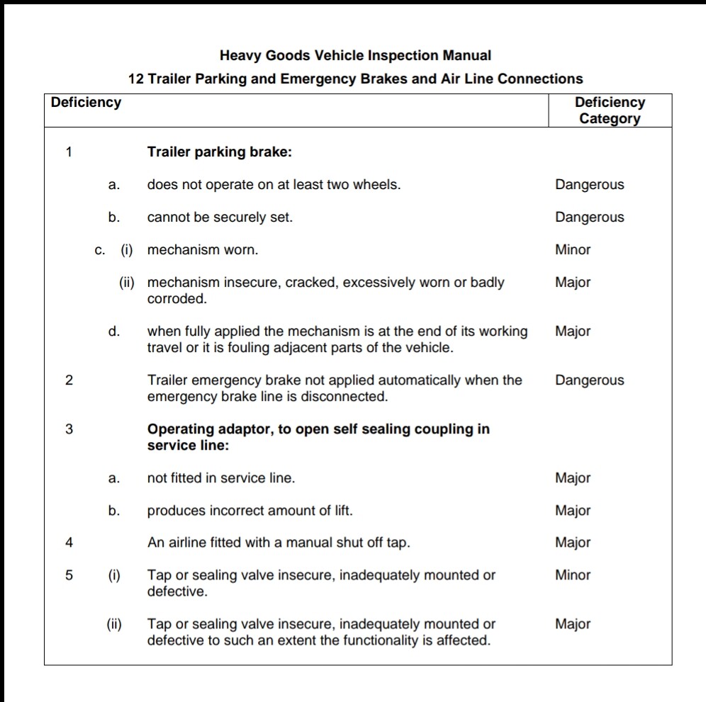

It really doesn’t matter if they are thought of as a good idea or not, they are not allowed to be fitted.
Heavy Goods Vehicle Inspection Manual
12 Trailer Parking and Emergency Brakes and Air Line Connections
20/05/2018 1 of 2 Document Uncontrolled When Printed
Application
This inspection applies to all trailers.
This inspection applies to drawing vehicles first used from 1 April 1989 and all trailers.
Procedure and standards
Emergency Brake and Air Line Connections:
Ensure that the air reservoirs on the drawing vehicle are fully charged.
With the vehicle parking brake on and the trailer parking brake off, ask the driver to
disconnect the service (yellow) and emergency (red) brake lines.
Check, on vehicles and trailers fitted with “C” type couplings, that the coupling in the
service (yellow) line - either fitted to the trailer or in the line itself - is fitted with an
operating adaptor which can open the self sealing coupling in the connector from the
drawing vehicle.
Check that the operating adaptor lifts the indicator on the test coupling by the correct
amount. The waisted portion (coloured section) of the indicator must be exposed, but no
more than this. This does not include additional couplings which may be used on trailers
such as extendable types.
Check that any brake line on the drawing vehicle is not fitted with a manual shut-off tap.
Additional taps fitted to extendable trailers are not included in this inspection. he driver must be instructed to reconnect all couplings before the vehicle is moved
When presented, the tractor unit must be compatible with the trailer and have a warning
lamp to indicate that trailer ABS is working (This may be a combined ABS/EBS warning light).
If presented with a compatible EBS tractor unit, if the red (emergency) line is dropped, the brakes
may not come on. To apply the brakes disconnect the ISO 7638 electrical connection. Ensure
that the handbrake is applied on the tractor unit before disconnecting the red (emergency) line
and that safe working practices are followed.
Provided self sealing couplings are used on the tractor couplings it does not matter whether
the air adaptor couplings are the conventional way or reversed.
Some park brake controls also deplete the air suspension systems when the red
(emergency) air line is removed, this is acceptable provided it does not drain the air brake
reservoir. If it does this is considered a deficiency under 5a of section 59.

You really should have defected that, they’re illegal. Maybe you’ll know better when you’ve a little more experience ![]()
