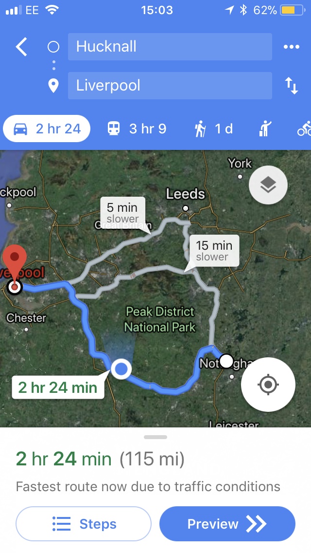

Just wondering what everybody’s Sat Nav routing is like and if you have encountered any problems with yours sending you out of your way.
I only ask because I wanted to travel from Speke, Liverpool to Hucknall, Notts in an artic and my Garmin Dezl on both fastest and shortest route settings wanted to send me to Leeds on the M62 then M1 south when the quickest and shortest route was M6 J16 A500 - A50 - M1 north.
I’ve set all the correct settings for an artic in mine but just don’t trust it. There’s no weight restrictions or low bridges on this route and is roughly 30 miles shorter.
Thanks.
There’s 5 mins difference and tbh I’d say via Leeds was more HGV friendly due to the stop/start at the roundabouts once you hit the A50 and the M6 roadworks.
Most truck satnavs try to come up with a Motorway route if there’s a sensible one available. Does it still give the same suggested route if you switch to car mode?
Having said that my TomTom 6000 suggests the M6/A500/A50/M1 route for a 38T artic.
But I don’t think there’s a 30 mile difference, is there? More like 10 miles? I suppose it depends on exactly whereabouts in Speke and Hucknall you are starting and finishing.
I’ve just tried it with car mode and its give me the route that I actually took.
I started out the journey at 6am yesterday morning so I don’t think traffic would have been a problem with it deciding what route to take.
I’m at a loss I just don’t trust it. I’ve got a truckers atlas too to consult.

Having said that my TomTom 6000 suggests the M6/A500/A50/M1 route for a 38T artic.But I don’t think there’s a 30 mile difference, is there? More like 10 miles? I suppose it depends on exactly whereabouts in Speke and Hucknall you are starting and finishing.
Does it still give the same route if you use it plan the journey now?
Yes it gives the same route.
I’ve updated it with the current software but I’m thinking that it must be faulty software.
Its one of the more expensive sat navs too.

Nothing wrong with it really - It’s just Garmin being Garmin. I did have the opportunity to run one alongside a TomTom for a few days a couple of years ago and wasn’t really impressed with the Garmin routing. Nothing really dodgy about it - in many ways it was simply being almost too cautious for the bulk of the journey. Then for the final mile or two it would have you diving off down some totally unsuitable roads (the drops were to residential properties).
FWIW I put the same journey into the Freight Journey Planner website and it also comes up with the M6/A500/A50/M1 route.

So it sounds like its Garmin`s shocking routing. It looks like I’m going have to cross reference it every time with my truckers atlas.

I understand what you mean as there are a few roundabouts on that particular route and the M62 being HGV friendly but not really fuel friendly which is what pretty much all companies expect of their drivers nowadays. Looking on google maps it shows roughly 30 miles difference but I suppose that’s just a guide and not 100% accurate. Cheers.
