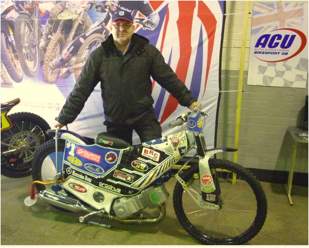

18000 rpm, simple to maintain. Built in Derby. one gear. 0 to 100mph in under 3 seconds running on Wood Alcohol. :stuck_out_tongue:
