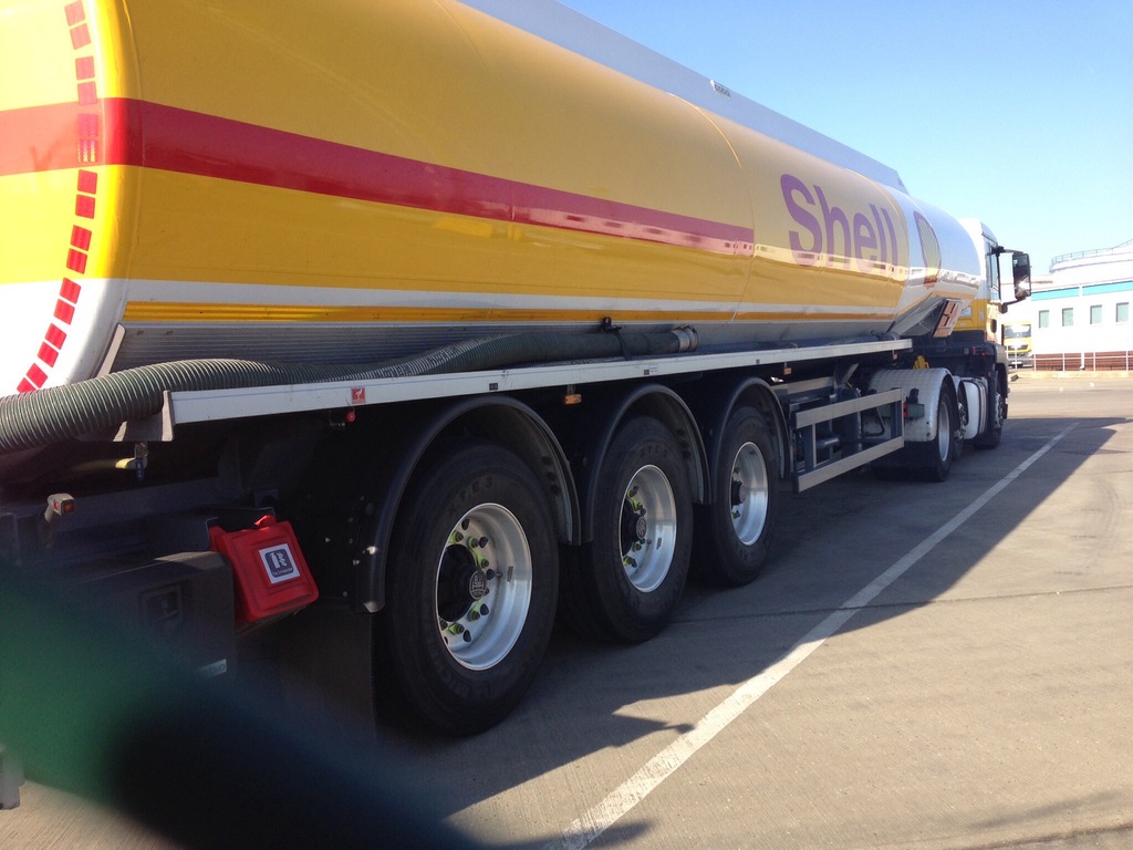

This Trailer was New in January 2015 and the Unit was new January 2014.
You may be able to see that the Unit has metal mudguards and the Trailer ones are plastic.
I’m sure that they both meet the regulations.
