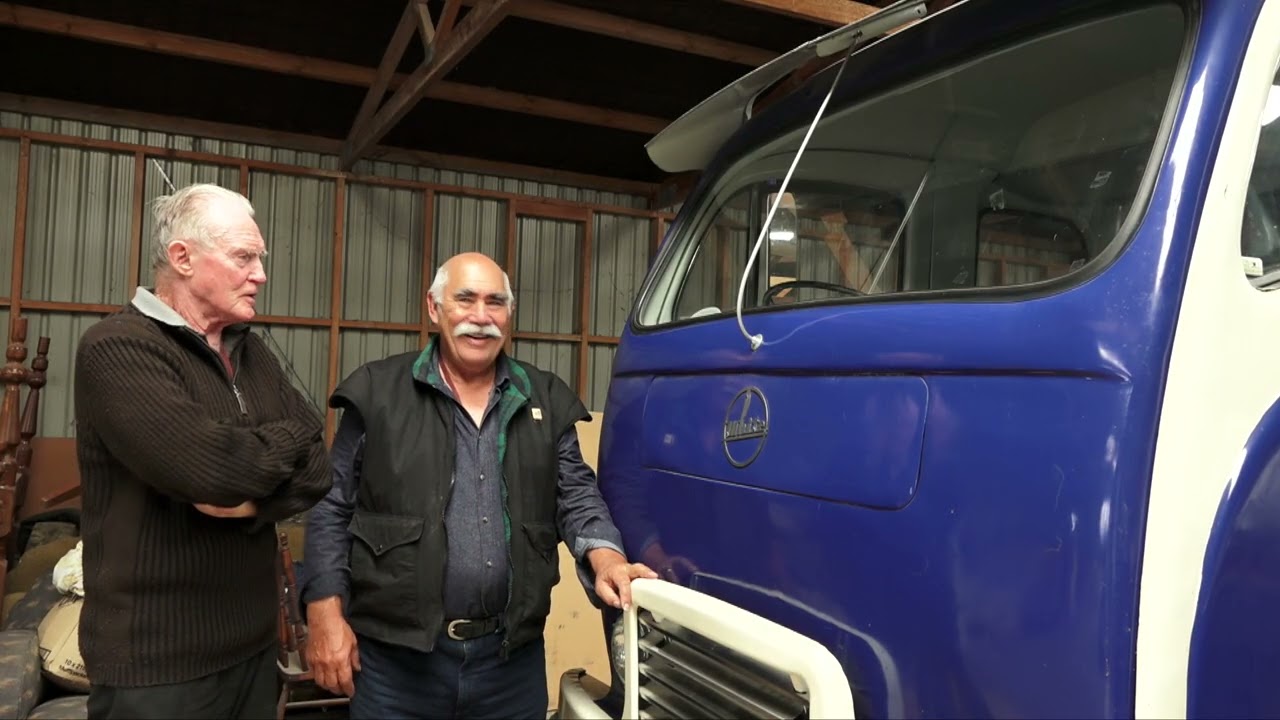

I reckon its a local coachworks that’s had a crack at the lorry cab.
