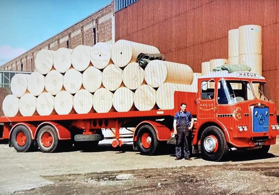

Now that picture means happy days for me. A Mk 1 Atki, in yellow not red, a slightly longer trailer and not necessarily the same loading location, but a typical load of Bowaters reels, neatly loaded, soon to be neatly sheeted and securely roped and off on another adventure maybe to a new to me place near wherever it was destined for. I just loved the life, criss crossing the country sleeping in comfy digs, suffering in the other kind and often in relative comfort across that old 150.
Can you believe it youngsters? I got £15 NO money and dinner bed and breakfast could be had for a tenner? :joy: :rofl:
