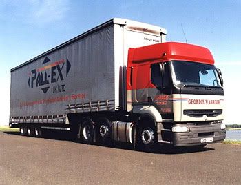

Pallex on the Road
or next to they :unamused:
