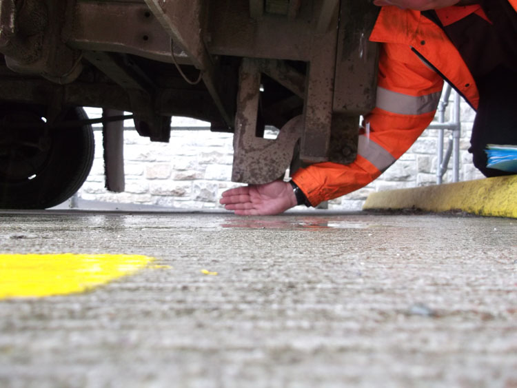

How do you know your overweight? Lorries do drive alot differently when heavy. Look for the signs if the double wheels are touching your overweight and if the mudgaurds are on the floor again your over. If your gonna run overweight the best advise is try not draw attention to yourself, wear your seatbelt, make sure the truck is looking good ie washed and not smashed in, dont drive like a prat etc. Being overweight isnât a big deal and you probably wont get caught just avoid driving past the regular checkpoints.

If your running over weight in a luton/3.5t van etc ideally you need one with double wheels at the back, you can quite happly take one of those up to about 4.5-5t gross which will give you a good 2t payload including a tail-lift. You can use single wheel vans at that weight but youâll have problems with rear tyre blow outs alot more, carrying a spare wheel is worthwhile and a good jack is advisable too because your typical car jack wont be man enough to lift it. From experience newer transits are much better than mercs, the springs are stiffer which stops the back end from sitting down too much.
It certainly looks overloaded, but I think that the pic shows the offside spring which doesnât look bad at all.
Is the vehicle parked on the flat or on a slope which may cause the rear to be low.
I can guarantee that if the pic is honest that it would be unlikely that I would be taking it on the road, the steering must nearly have daylight under the wheels!

Itâs always important to remember that you can be within the overall Maximum Authorised Mass of the vehicle but overloaded on one or more axles. If the photo is anything to go by, it sounds like the bodywork fitted and the distribution of the load within that bodywork is putting far too much on the rear axle.
Iâve only ever glanced at these vehicles, but IĂ seem to recall that the frozen and chilled compartments are at the front - presumably to make the installation of the fridge unit easier. This means that the ambient compartments are at the rear, where the heaviest part of the load will go.
The management need to be told that they cannot go so close to the MAM without careful consideration of the load distribution and checking that the rear axle is not overloaded. The heaviest containers need to be loaded as far forward and as low as possible.

looking at the photo I would say its the axle weight you gotta watch. The load might be under weight but to much on the rear axle which is down to load disrtibution
