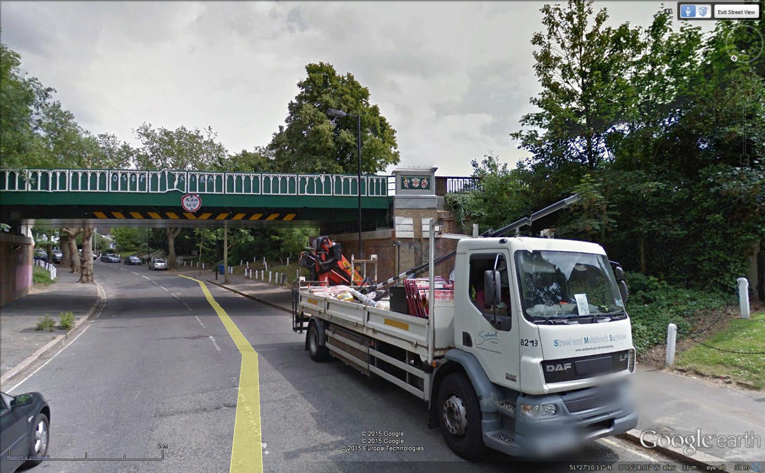

Oops - Don't forget to stow your HIAB
Stowed correctly, this bridge presents no problems…
Stowed Incorrectly however…
The particular HIAB lorry visible in both the “old” google earth shot above being parked in the same place as the one in the background in the BBC story - suggests that this is NOT the wagon that is involved - the driver probably lives there, or less likely perhaps - he’s doing work at that property that’s been going on longer than the time difference between the two shots…
Nice one… Leccy line too, very lucky escape for all.

Hiab looks stowed to me on the top photo
