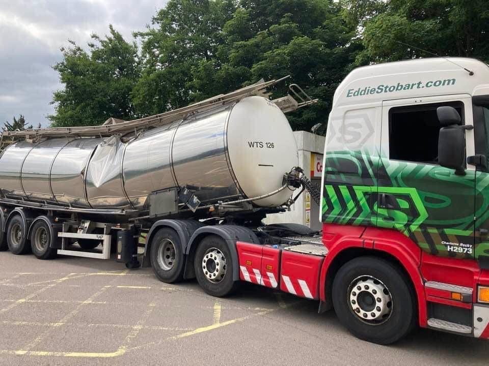

Just limbo underneath it! Guess that the driver thinks that venting is something that you do on social media!
the maoster:
For any of you chaps or chapesses who’ve never touched tanker work there are IMO only two possible causes of this; the driver has either discharged the load by pump or gravity with his/her lids shut, or the vent line closed, or more likely given the absence of product labels then he/she has had the tank washed out using a hot wash and has immediately zipped it up (closed the lids and outlet valves) whilst the tank is still red hot and as it’s cooled it has created a vacuum. My money would be on the latter.
I’m with you Moaster, can’t see it folding up like that, gravity discharging.
Star down under.:
Yeah I agree mate. I was gravity discharging beside another fella who was doing the same once and he had his lids closed and we could hear the tank “taking great big gulps of air”, no harm done as we both immediately recognised the problem.
At face value it looks like the tank itself is being used as a stressed trailer chassis component and has failed.Or there is a chassis rail assembly between the pin and the axles which has failed.Dont think a collapsed tank alone should cause that amount of carnage to the trailer’s structure.
There wouldn’t be enough pressure form a gravity discharge to cause that. Most likely after a washout. Although it could also have been caused if they were tipping using a decent pump and hadn’t opened up any vent valves, seen the aftermath of that happening before and looked very similar
Ahem…
youtube.com/watch?v=Zz95_VvTxZM
I’d agree that the post shows a cleaned tank that’s been sealed too quickly, not least of all because the there’s no DG markings in the hazard warning panel area
