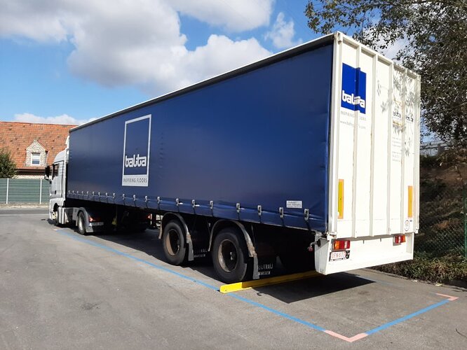

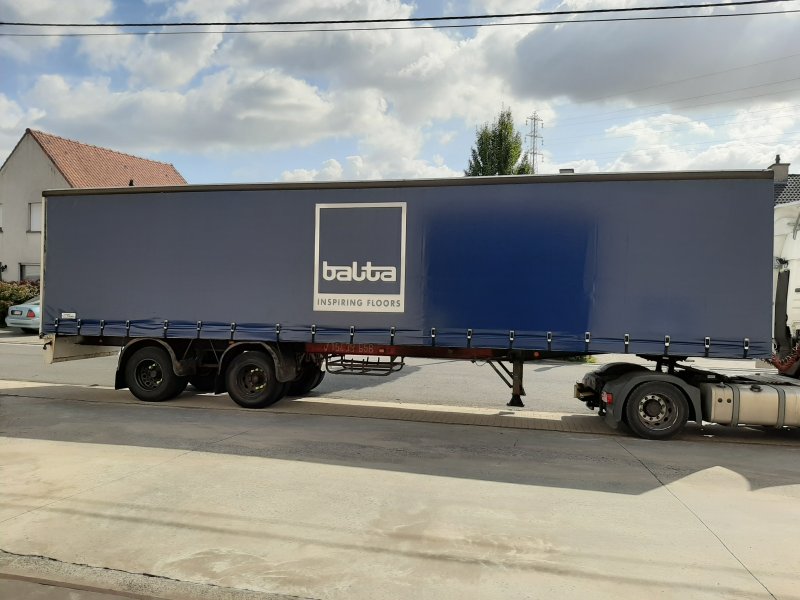

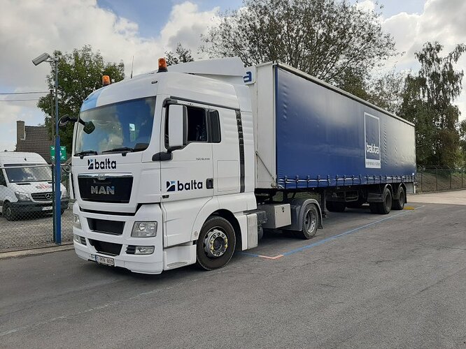

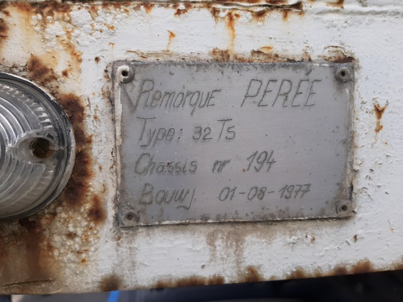

Anyone still driving around with an old trailer??
Drove last week with this beauty from 1977.
Curtains are relatively new.

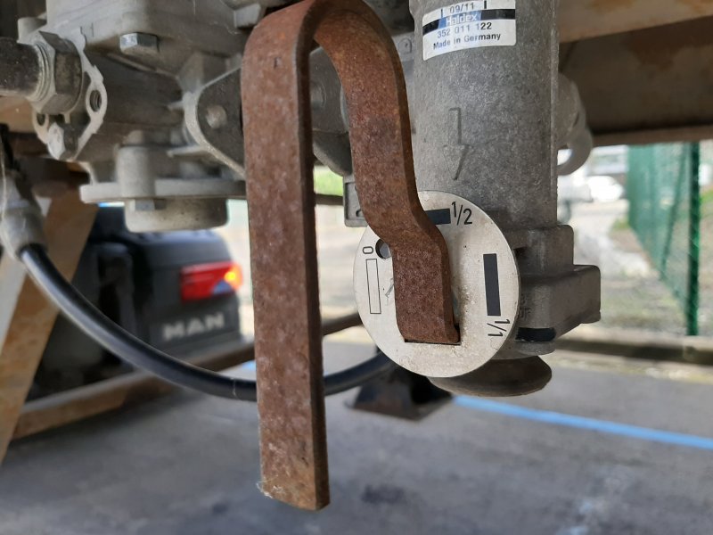

Hello Vosa
Empty position.
Partly loaded.
Fully loaded.

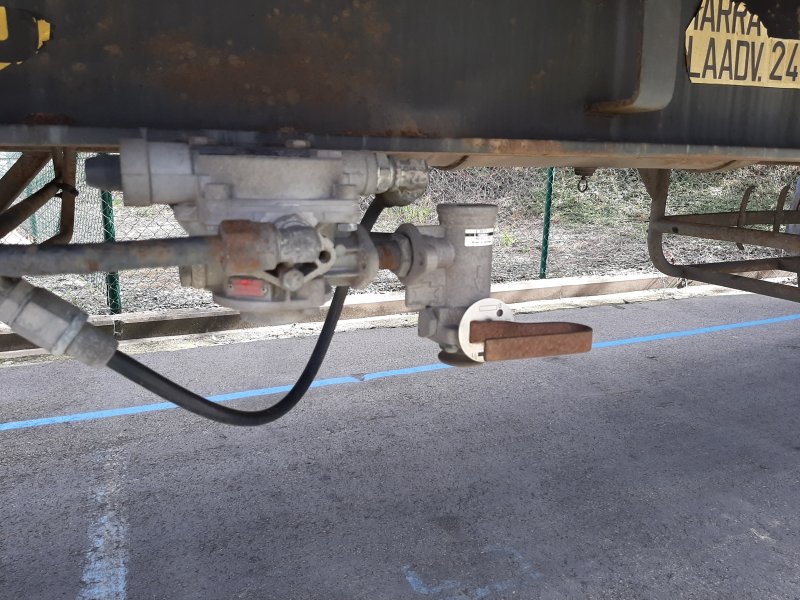

Some of the old tank trailers we had at Meulemeester were lovely to work and pull around, cable handbrakes, leaf springs and non stain stainless steel.
Coo, haven’t seen one of those manual trailer brake pressure adjusting valves for well over 30 years, we had them on bulk artic tippers back in the day before load sensing valves became de rigueur, they worked well.
First time i found out, as a youngish driver, if you presented a case well pointing out how it was of benefit to the company and not just another driver winge about something, that you could get things changed for the better, the whole fleet was retrofitted with them.

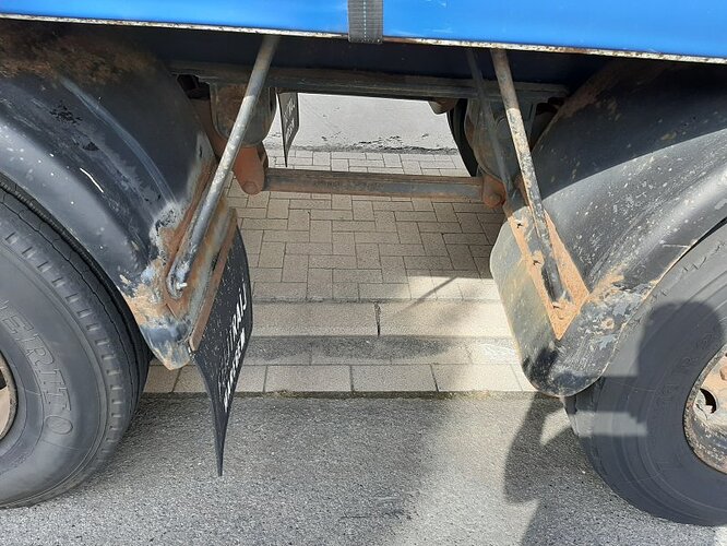

A set of staybrites and that trailer would look the ■■■■■■■■, and is just me who would want to soak those poor rusting springs in grease and wrap them.
Juddian:
Is it just me who would want to soak those poor rusting springs in grease and wrap them.
I did suggest last week to grease them. I’m still waiting for their answer.
A general purpose trailer is a pretty simple thing (any modest sized engineering company should be able to churn one out) and as such you can keep them running nearly forever. It’s just a matter of how much money you’re prepared to throw at them over the years.
Pulled one of our oldest tankers Friday, built in 1992. 1992 doesn’t seem that long ago until you realize it’s 27 years ago, I imagine even Carryfast was working back then it’s that long ago!
Sign of getting old I guess.
1977 is mightily impressive though, year I was born and it certainly looks in better condition than me

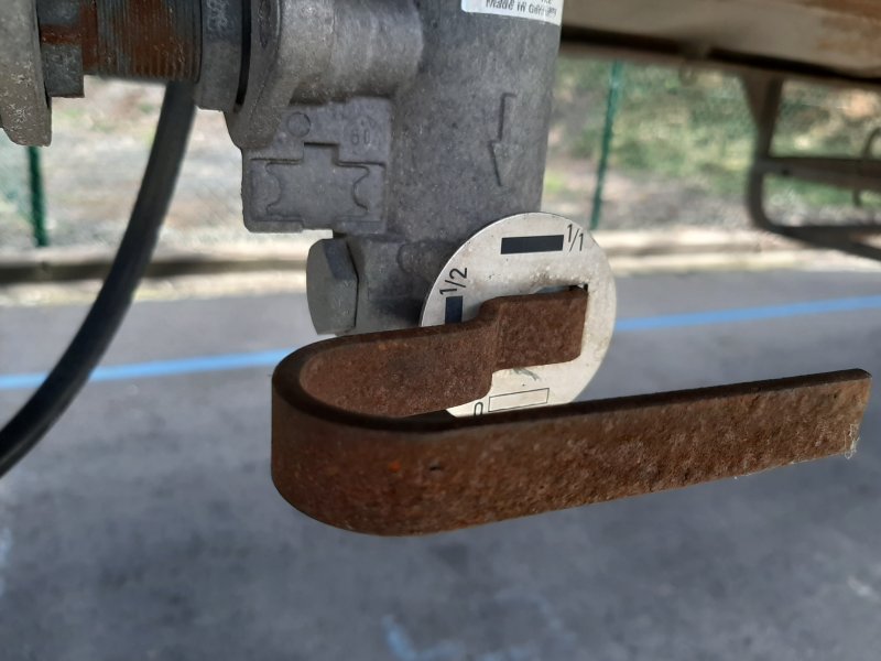

Forgive me for asking but I wasn’t even born in 77. What is the pressure adjusting valve for? And when would you alter it between the positions and for what reason? I take it this is something that’s electronic and automatic on modern trailers?
And there was me thinking our 2003 Schmitz euroliners were a tad on the old side!
Rowley010:
It’s there so you can alter the amount of air going to the brakes eg:-
:- when loaded you’d change the valve to the loaded position which in turn forces more air to the brakes.Depending on weight loaded.
You wouldn’t want to drive empty with the valve in the loaded position because the brakes would lock up leaving a 1000km of tyre tread on the road.
So once you were empty, you change the valve to empty.
With multi drop work, you would change the setting to part load once you had unloaded the first 5/6 ton.
Todays trailers pretty much do all this automatically.
Geoffo:
Rowley010:
Forgive me for asking but I wasn’t even born in 77. What is the pressure adjusting valve for? And when would you alter it between the positions and for what reason? I take it this is something that’s electronic and automatic on modern trailers?It’s there so you can alter the amount of air going to the brakes eg:-
So once you were empty, you change the valve to empty.With multi drop work, you would change the setting to part load once you had unloaded the first 5/6 ton.
So I’m guessing that the opposite to leaving it in full position when empty, so leaving it in half position when fully loaded would mean you’d end up ■■■■■■■■ your pants trying to bringing it to a stop?
Something like that. Yes.

Those valves are handy for TUV / MOT testing, instead of tying the load sensing valve up like we do, the Dutch designed a valve for it. ![]()

Problem with greasing them is the geease attracts dirt which then mixes with the grease to make a grinding paste, only springs that benefit from oiling/greasing are classic cars and thats only really to stop them seizing up or the leaves spreading apart.
As these operate on a sliding spring hanger, wrapping them to stop dirt ingress will be almost impossible, plus you cannot then inspect the leaves for cracking.

Did the benefits of leaving them dry outweigh the downsides, for years we had autolubed shackles on tractor units, invariably the oil spread down through the spring leaves.
You’d have thought some clever bugger would have come up with a quick release plastic or rubber sleeve for multi leaf springs, so they could be lubed, protected from the elements and inspected without too much aggro.
