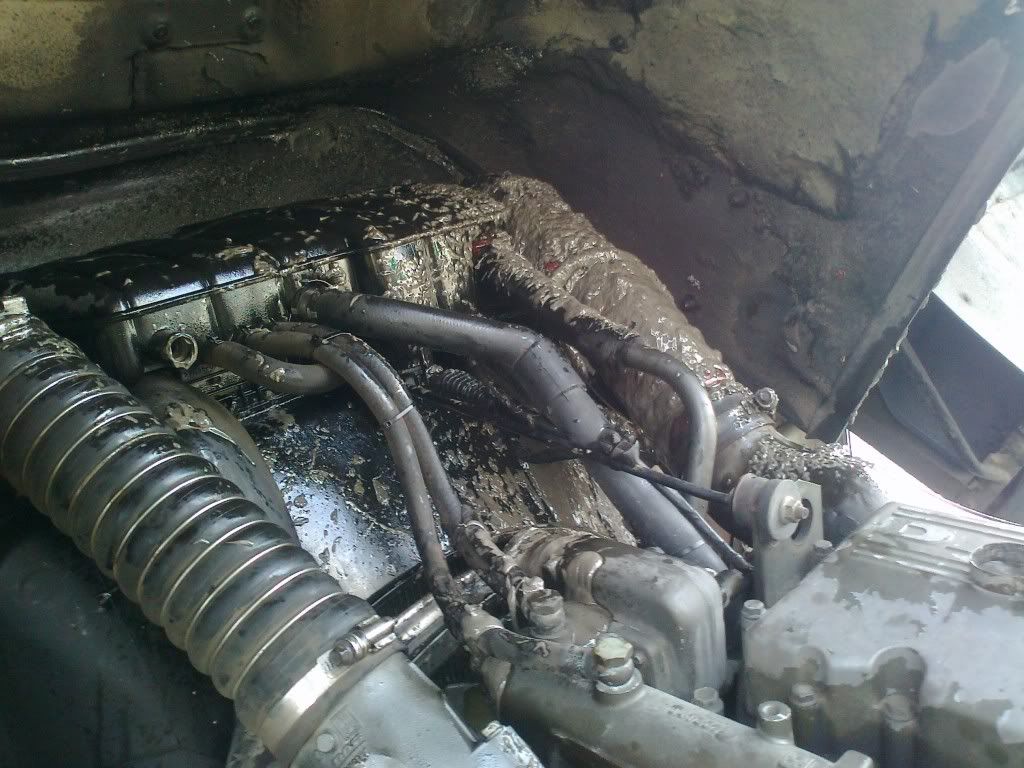

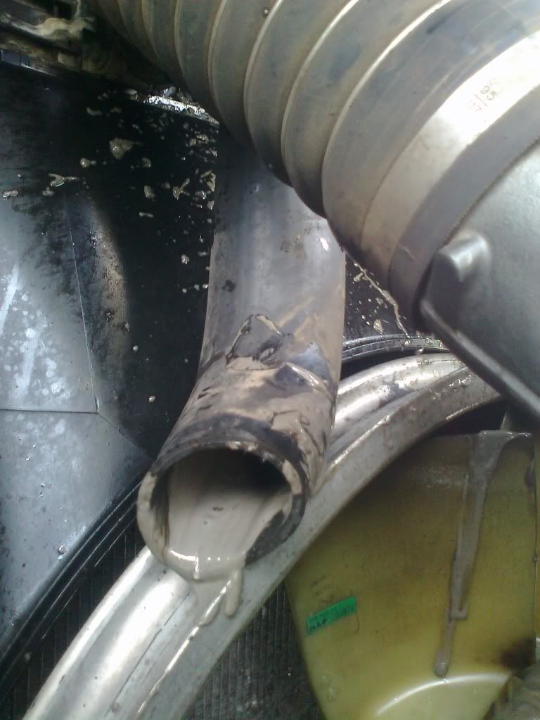

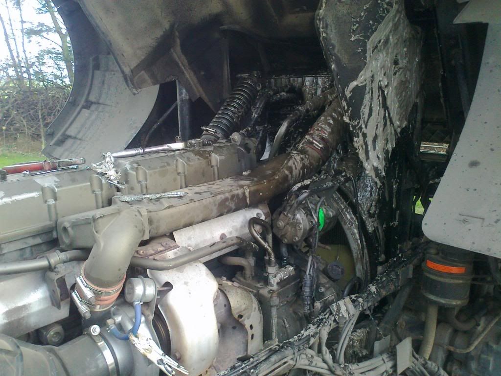

this was at exlby services southbound on the A19, i knew what had happened because i found the problem day before at barnsley but was on a four dropper so decided to finish of my duties so to speak, my last drop was middles borough the following day, things thickened up during the night and she over heated after tipping at middlesborough, i stripped all the pipes off in the services and bunged a load of shampoo(yes for your hair) and other cleaning products in the system, bless the old lass, she ran hot but i managed to get back to daf at scunny :open_mouth:
got it done partially under warranty as the oil cooler was 15 months old - the first time it went i ended up replacing every hose on the engine as the oil rots the pipes from within, after two hose failures(and consequent loss of earnings) i bit the bullet and changes every hose. after the second cooler failed i took them all off and cleaned them by hand!! that was a ball ache!
forgot to say - wait until you find gearbox oil in your header tank! thats expensive!!
