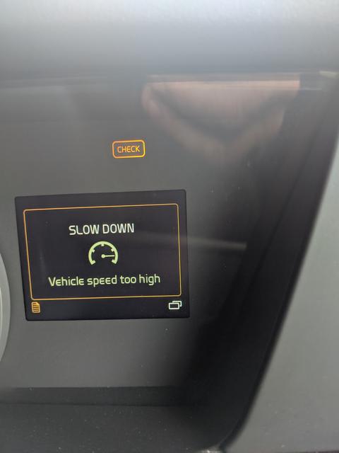

This fast enough.
switchlogic:
How are you measuring the actual speed?
gps app and sat nav , measured between M55 junction and Forton services… a nice level 8 mile stretch
biggriffin:
This fast enough.
There goes your bonus. Did the office call you to tell you you were driving dangerously and someone could be killed by allowing your vehicle to go 5mph quicker?
