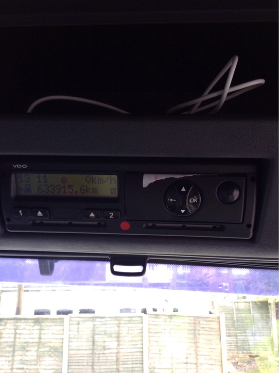

We have a new 16 reg motor that has a new design of tacho head unit, anybody know of any differences…apart from the look
Not used one myself, but looking at it its just a facelift design, I would imagine it will operate the same as the old units.
TheNewBoy:
This is my 2008 VDO unit below I think it’s just been face lifted
Looks like they’ve done away with the separate eject button ?
Assuming you’d need to hold the relevant button to eject card.
I’m hoping so anyway, double manning would usually result in eject when the driver put driver 2 on other work, only to eject the card by pressing wrong button, and there’s no going back once eject is pressed, even in error.
*edit, yes they have.

TheNewBoy:
Is that a new VDO one, or one of the less common makes? (It’s not a Stoneridge)
I would guess that the operation would be generally the same, but the manual entry may be different to what you’re used to.
It also may count down the driving time from 4h30, rather than up from zero, which is what the newest Stoneridge units do.

It’s the new Siemens tachograph model 2.2, I don’t think there are any serious changes in operation but I’ve only had a quick look.
Here’s the instruction manual
It appears you can do manual entries with a smart phone app.

To eject just hold down the driver picture for about 3-5 seconds.
Works the exact same way as previous Siemens tachos, but I think you can also get a driving time countdown like you get on the Stoneridge ones as well.

It wasn’t displaying in Tapatalk, so I didn’t notice it earlier. But yeah, the OP’s is the same one with out the branding.
BTW, VDO are no longer part of Siemens, so they are not branded as Siemens VDO any more.
